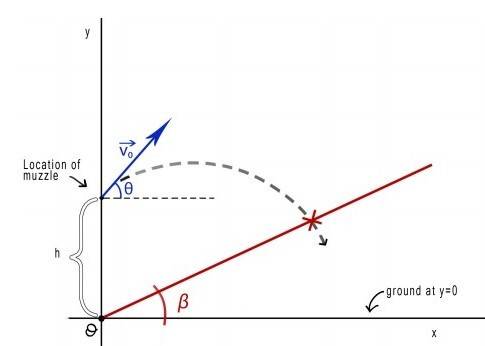

Consider the projectile motion shown in the figure below, where air resistance can be approximated by the linear regime. The red line represents an inclined hill, which can be assumed a straight line passing through the origin, making an angle with the horizontal
(a) Find an equation that defines the time t[SUB]h[/SUB] when the projectile runs into the hill. You can use all the results derived in lecture for projectile motion with linear drag.
(b)Accurate to first order in the linear drag coefficient, solve for the time t[SUB]h[/SUB]

Okay, for part a, I used Eq 1
I let vy=vy(th)=0 --->The reasoning is that the projectile would stop moving for a short time when it hits the incline, but I have a feeling that reasoning is faulty
I let vy0=v0sinθ
Then the equation became
(vter-v0sinθ)/vter= e-th
I multiplied both sides by the natural log, then got
th= (m/b)-v0sinθ/g
I think this is wrong, but I'm not sure how to approach it differently or where I'm going wrong.
Obviously, I have not attempted part b, but I'm exactly sure I know what it is asking me to do. What does accurate to the first order linear drag coefficient mean?
Your reasoning that you should search for a point where velocity is zero is definitely not good, since that brief moment you speak of is not described by the trajectory of the projectile(That trajectory judging by it's equation would continue through the inclined object if it was possible, you just stop it there since you know there is going to be a collision).
However, I find it very hard to read the equation you've given, and also, is that equation just for vertical component of velocity? In case when there is air resistance, both horizontal and vertical components will change over time, since drag force will have components along both axes.
So it would be good if you provided formulas for both components. That is in the case where you are not yet able to solve differential equations from which those formulas would be derived(This is listed as introductory physics problem, so I wouldn't know your level of math). In case you're familiar with differential equations, the first step would be to solve Newton's second law for both components of velocity, then find the trajectory, and finally find the intersection of the trajectory with this line that represents the inclined hill.

As @Antarres has pointed out, the motion is not symmetric about the apex. Further, it would not be helpful to find the time to return to y=0; and thirdly, it is generally a mistake to break trajectories into before apex and after apex: as long as the same equations apply in both, that's just extra work.

From post #1, it appears that solving the acceleration equation for 2D linear drag is something already covered in class and Moolisa has the result for velocities. Whether @Moolisa also has the result for displacements (which is needed here) is unclear.
Thank you, I solved the problem and got the correct answer. It was tedious... Thanks for the help, I'll edit it to say it's been solved
