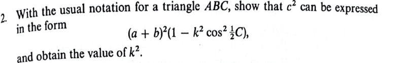

See attached.
Trigonometry
In my working i have,
##\cos C = 2\cos^2 \dfrac{1}{2} C -1##
##c^2= a^2+b^2-2ab(2\cos^2 \dfrac{1}{2} C-1)##
##c^2= a^2+b^2+2ab(1-2\cos^2 \dfrac{1}{2} C)##
##c^2= (a+b)^2 (1-2\cos^2 \dfrac{1}{2} C)##
Now from here, ##k^2 =2## but text gives different solution. I am still checking this...am i missing something guys?
From the third line
[tex]c^2=(a+b)^2 (1 - 4\frac{ab}{(a+b)^2}\cos^2 \frac{C}{2})[/tex]
So
[tex]k=\frac{\sqrt{ab}}{\frac{a+b}{2}} \leq 1[/tex]

Ok nice one, i can see that
##(a+b)^2\left[\dfrac{(a+b)^2-4ab}{(a+b)^2}\right]≡a^2+b^2+2ab(1-2\cos^2 \dfrac{1}{2} C)##
but the text solution is ##k^2= \dfrac{4ab}{a^2+b^2}## and not ##k^2= \dfrac{4ab}{(a+b)^2}## as you've shown.

You have left out the cos2 on the left hand side of that first equation. It should read:
##\displaystyle \quad\quad (a+b)^2\left[\dfrac{(a+b)^2-4ab\,\cos^2(C/2)}{(a+b)^2}\right] = \dots ##
This is consistent with @anuttarasammyak's result and simplifies to:
##\displaystyle \quad\quad (a+b)^2\left[1-\dfrac{(2ab)\,2\cos^2(C/2)}{(a+b)^2}\right] ## ,
which can easily be compared to the 2nd or 3rd line of your OP.

@anuttarasammyak you're 💯 correct. Cheers!
Was good question 🤣🤣🤣 mixed me up a bit. Wah! Expand with ##2ab## first, then factorize to have ##(a+b)^2## then divide each term by ##(a+b)^2## and multiply whole by ##(a+b)^2##.
Will post later once I get hold of laptop.
What i was missing was:
##a^2+b^2+2ab(1-2)##
on expanding we get;
## a^2+b^2+2ab-4ab=((a+b)^2 -4ab)##
then divide each term by ##(a+b)^2## and multiplying by ##(a+b)^2## realizes,
##= \left(1-\dfrac{4ab}{(a+b)^2}\right)×(a+b)^2=(a+b)^2\left(1-\dfrac{4ab}{(a+b)^2}\right)##

Maybe that was your problem, but in the threads you post, it's often difficult to tell where you're having difficulty, because all too often you skip steps and/or do not explain what you're doing.
For instance, in the OP of this thread you have:
Smaller steps give:
##\displaystyle \quad\quad c^2= a^2+b^2+2ab(1-2\cos^2 (C/2)\, )##
##\displaystyle \quad\quad c^2= a^2+b^2+2ab-4ab\cos^2 (C/2)##
##\displaystyle \quad\quad c^2= (a+b)^2-4ab\cos^2 (C/2)##
##\displaystyle \quad\quad c^2= (a+b)^2\left(1-\dfrac{4ab\cos^2 (C/2)}{(a+b)^2}\right)##
