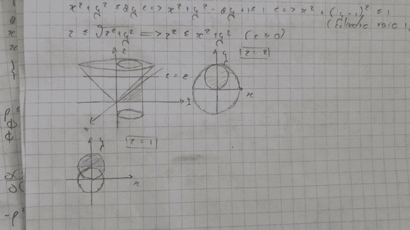

I am given this expression which represents an object in 3D and the goal is to determine its volume using multiple integrals.
I started by drawing what I think is the object as well as two "slices" of that object on different planes (z=2 and z=1)
I have tried using cartesian, cylindrical and spherical coorddinates but I get a final result that seems impossible to integrate. My first instinct was to try to use Cavalieri's principle but I can't find a way to write the area of each "slice" only in terms of z. I think the problem is I'm not writing the limits of integration correctly so if anyone could help me out with that, it would be much appreciated.
(Final result is supposed to be 32/9)

It looks to me like cylindrical co-coordinates will work.
In what order did you do the integration, when you tried them?
Can you write down the equation for the circle in polar coordinates?
There are two options:
1) You can place the origin of the cylindrical coordinates at the origin.
(2) You can place the origin of the cylindrical coordinates at the centre of the circle [itex]x^2 + (y-1)^2 = 1[/itex].
The first of these leads to a simple integral; the other does not.

I tried integrating first z then r then teta because i wrote z in terms of r and r in terms of teta
I think that might be where my problem was but now that I look at it again it should be something like 0≤r≤2sinθ ; 0≤θ≤π
