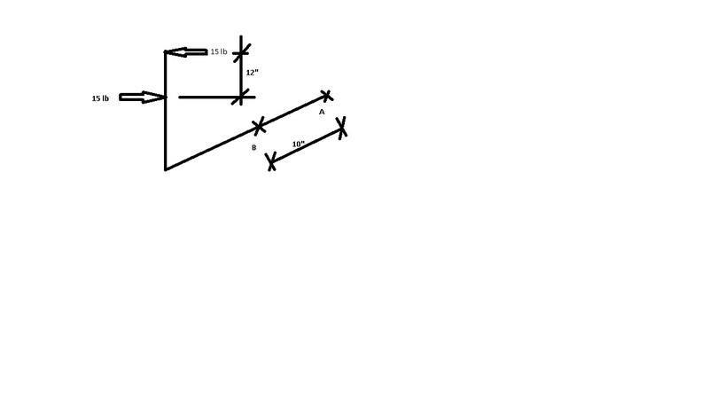

The forces shown in the Figure below form a couple. Replace the couple shown with an equivalent couple acting at points A and B. Please see figure
Couple force moment equation is M = Fd (take only one of the two force vectors and distance between them)
Actually, I don't understand what they want. I was just going to do M = 15 lb x(12in) but this question is for 6 marks so I'm definitely missing something. Please advice if you know what this question means.
Thank you,
Faisal Shibli
… this question is for 6 marks so I'm definitely missing something. Please advice if you know what this question means.
The 6 marks do seem strange. :confused:
The question seems to be asking for a pair of opposite parallel forces through A and B …
which could be at any angle …
with the same Fd.
Looks to me like a badly worded and badly drawn question. My response was to have a couple at A and B with forces perpendicular to AB. I wonder if I would have passed.
