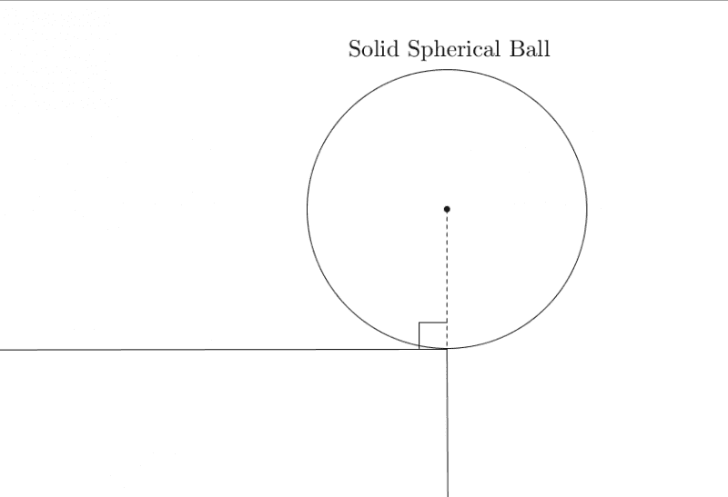

A solid spherical ball is placed carefully on the edge of a table in the position shown in the figure. The coefficient of static friction between the ball and the edge of the table is 0.5 . It is then given a very slight push. It begins to fall off the table.
Find the angle (in degrees)(with vertical) turned by the ball before it slips.
3. The attempt at question
I have came up with some equations. Let ##\theta## be the angle(with vertical) at which the sphere begins to slip.
By conservation of energy
##mgr-mgrcos\theta =\frac { 1 }{ 2 } { I }_{ 0 }{ \omega }^{ 2 }##
As ##v=r \omega##
So ##g(1-cos\theta )=\frac { 7 }{ 10 } \frac { { v }^{ 2 } }{ r } ##
By finding torque about the contact point
##mgsin\theta r=\frac { 7 }{ 10 } m{ r }^{ 2 }\alpha ##
As ##a=r \alpha##
So ##\frac { 5gsin\theta }{ 7 } =a##
Also from FBD of the block
##mgcos\theta -N=m\frac { { v }^{ 2 } }{ r } ##
and ##\\ mgsin\theta -\mu N=ma##
I don't know if these equations are right. Please help.

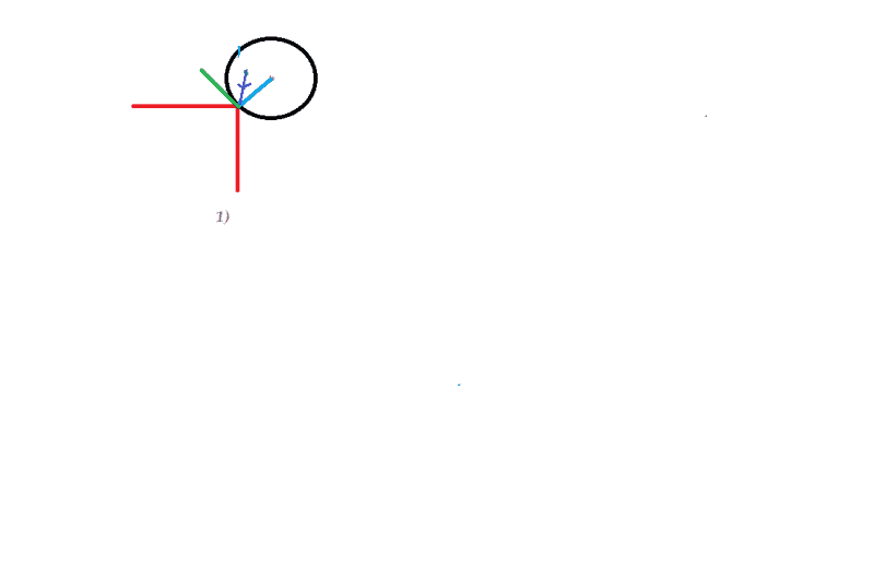

Consider the element of the sphere just touching the corner, it is stationary.
Then how should I proceed?
But the rest of the ball is not. How do you justify the insignificance of that?
The sphere is rigid, you need to assume that the force on every single atom is equal.
Jilang said:
The sphere is rigid, you need to assume at the force on every single atom is equal.
Why?
Do you think that the force of gravity only acts on the centre of mass?
Personally, I would use a co-rotating frame. In that frame, the ball is in equilibrium. The sum of real and fictitious forces is zero.

Consider a uniform bar with its centre as the point of contact. It would require a centripetal force to get around the corner even though its mass centre does not.
Calculate it from first principles by integration.
I don't understand what you want me to calculate. Please explain more.
Hm, interesting. Unless I made a mistake in integration, total centrifugal force is ## m \omega^2 r ##, that of a point mass, which means Satvik's disputed normal force equation was correct :)
But was the way in which I found it incorrect?
As I said earlier, you assumed you could treat the ball as a point mass, and that was not justified.
Have a look here:
http://en.wikipedia.org/wiki/Rotating_reference_frame#Newton.27s_second_law_in_the_two_frames
The sum of the centrifugal force, Euler force, normal force, weight and friction must be zero (the Coriolis force is zero because the ball is stationary with respect to itself). The centrifugal and the Euler force must be integrated to obtain the force balance.
