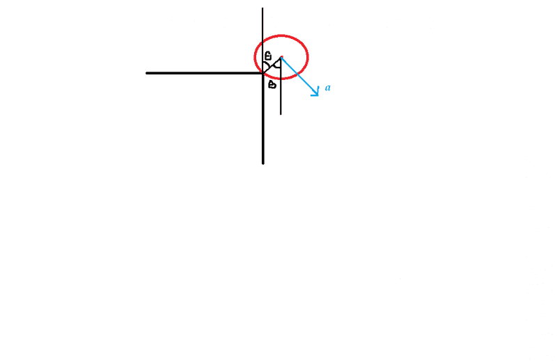

  • #31
Can this be solved without using rotating frame of reference because I haven't became familiar with it.
  • #32
Yes. And there is no large difference between a fixed and a rotating frame, the equations look similar.
Which net force is needed to keep the ball on its circular track?

Your error was explained to you.
Jilang said:
just shut up
Being rude won't help you with physics, Jilang.
  • #42
voko said:

Centripetal force acts towards center. And in this case center(point of contact) is also the origin. So it Centripetal force acts towards origin. So it should be (-)ve?
voko said:
To simply things further, let's select some convenient coordinates. Let the origin of the coordinate system be at the contact point, and the Ox axis pass through the centre of the ball. Then it should be fairly obvious that ##F_y = F_z = 0## - is that obvious to you?
Let blue and green line be the x and y axis. Suppose there is a mass which experience centripetal force along that blue line. That force can be broke in x and y components. Why is ##F_y = F_z = 0##?
