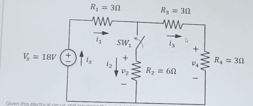

- Homework Statement
- For switch open,
A) i2?
B) v4?
C) i5?
For switch closed,
D) Req?
E) isource?
- Relevant Equations
- Series and Parallel addition laws. V = I*R.

It looks correct. Have you any question?rugerts said:Homework Statement: For switch open,
A) i2?
B) v4?
C) i5?
For switch closed,
D) Req?
E) isource?
Homework Equations: Series and Parallel addition laws. V = I*R.
