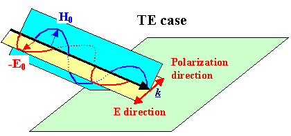

I would like to measure the DoLP of outside daylight at the horizon with the sun overhead (midday in summer). Found this equation: DoLP = (reflectanceS - reflectanceP) / (reflectanceS + reflectanceP)
Where S and P are defined:
“The two orthogonal polarization planes are s, perpendicular to the plane of incidence defined by the
surface normal and the incident ray, and p, parallel to the plane of incidence.”
(A diagram showing what this statement refers to would be helpful as I am not familar with the terms used.)
I know that to get the S and P amplitude values I need to measure the light through a linear polarizer turned to one angle and then a different angle. Can someone tell me what two angles I need to rotate the polarizer?

The English equivalent of S and P components are TE (transverse electric) and TM (transverse magnetic), respectively.
See pictures below for the orientation of each case:

Based on the above pictures, how do you conclude about the angle through which you will have to rotate your polarizer?
It looks like they are 90 degrees apart, right?
Right.
