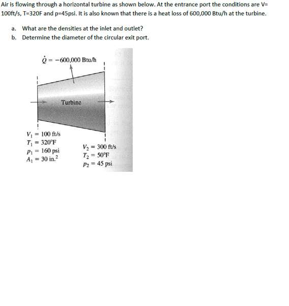

I attached the file.
I just wanted to clarify something.
All i need to find is the density @ inlet&outlet and the diameter at the outlet.
The heat loss they have shown has no impact on the values that were asked for right?
density can be found by pressure/(RT) where R=gas constant and T=temperature
And the diameter can be found by setting the mass flow at the inlet = mass flow at the outlet.
The problem states the inlet pressure is 45 psi. But the diagram shows 160 psi at inlet. The 45 psi is shown at the outlet. Something is amiss.
But to answer your question, if you know P and T, you can determine density. Knowing that you know the mass flow. The heat loss has no impact on the values asked. Conservation of mass will determine exit area.
Yeah I noticed that typo too. The prof said to assume it is 160 psi. Okay I thought so.
Basically my calculations for the density was pressure/(RT)
Where R=gas constant of air and T=temperature in rankineI just said set (density at inlet)*(Velocity at inlet)*(Area of inlet)=(density at outlet)*(Velocity at outlet)*(Area of outlet) and solved for the exit area.

Oh okay, I just solved the problem, but something weird happened.
The way the picture is drawn, the outlet area should be bigger, but the area I got issmaller than the inlet.
Yes, I also end up with a larger exit area. But rho*A*V = constant. Working fluid is air. If you know pressure and temperature, you then know density. The trapezoid symbols used for compressors and turbines in thermo texts are meant to infer the working fluid is compressed or expanded. The numbers in this problem are strange.

Thanks. did you get diameter = 0.453 ft?
I talked to a friend. He says turbines are supposed to have a smaller outlet area than inlet. And that the figure is drawn like a diffuser instead of a tirbine.
I do not calculate 0.453 ft^2. I get a little over 23 in^2 which is 0.16 ft^2.
First I calculated the two densities
At 1: density=P1/(RT1)
P1=(160 lb/in^2 * 12in^2 / 1ft^2)
R=(1716 ft*lbf/(slug*R)
T1=320+460 R
P1= .0172 slug/ft^3
P2=45 lb/in^2 * 12in^2/1ft^2
R=1716 ftlb/(slugR)
T2=50+460 R
Density 2=.0074 slug/ft^3
COnservation of mass:
(.0172)(30/144 ft^2)(100ft/s)=.0072 slug/ft^3 * 300 ft/s * A2
A2=.1614 ft^2
Diameter=.453 ft
Crap! I just wrote this all out for no reason. I meant I got diameter=.453 ft. I got Area=.16 ft^2 as well.
