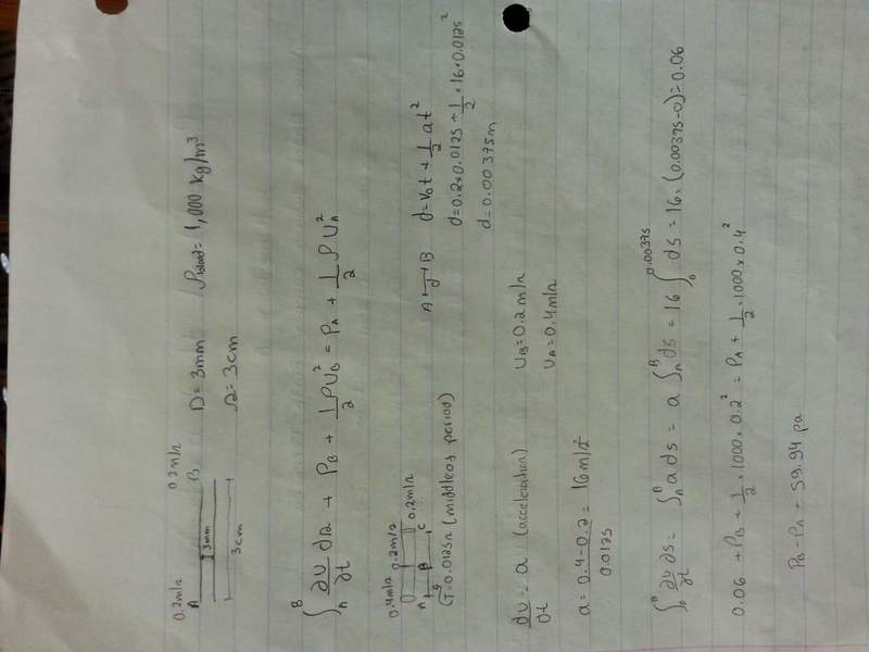

I have a question about fluid mechanics. I know it's not completely physics, but in the end, it involves physics:
Suppose you are computing the blood flow in an artery segment with length 3 cm and diameter 3 mm. The artery has a constant cross section and its positioned horizontally in your computation. Assume the density of the blood to be 1,000 kg/m3. Blood is incompressible. At some point in your computation, in a time period of 0.025 s, the average flow velocity you specify at the artery inlet changes from 0.2 m/s to 0.6 m/s. Based on the Bernoulli's equation, at the middle of that time period, what do you estimate/expect the blood pressure difference between the artery inlet and outlet ?

So, I used the Bernoulli's equation for unstedy flow, then I assumed that the acceleration is uniform (but i think it's wrong). Taking the constant acceleration, I measured the distance the blood traveled in the middle of the time (0.0125s) and the velocity in the beginning and at t = 0.0125s. Then, I just substituted in the formula. The problem is that I don't think it's this simple, because the blood velocity may not vary linearly.
