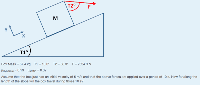

Free-body setup of a box of mass M on an incline at angle T1, with a force F applied at angle T2 above the slope, and axes X and Y marked; the box is drawn on the ramp surface.

I already found the following for previous questions:
mg=-661.9
mgx=-3594.37
mgy=-649.91
Fx=2192.69
Fy=-1250.69
FF=-365.44
Vf=257.18
ΣFx=-1767.12
ATTEMPT #1
v=d/t
d=vt
d=(257.18)(10)
d=2571.80 (incorrect)
ATTEMPT #2
ΣFΔt=mΔv
ΣFΔt=m(d/t)
[ΣFΔt/m](t)=d
[(-1767.12)(10)/67.4]10=d
-2621.84=d
ATTEMPT #3
ΔV=Δd/Δt
ΔvΔt=Δd
(257.18-5)(10)=Δd
2521.80=Δd
I am not sure where I am going wrong!

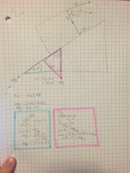

Handwritten physics work on graph paper: a force diagram of a block on an incline with labels F, N, FF and mg, an angle of 10.6 degrees, the equation mg = (67.4)(9.81) = 661.19, and two triangle decompositions of mg with sin-theta relations.
I keep getting the same things (Sorry about the bad quality photo, but I figured this was best so the triangles I made can be seen).
In your pink triangle drawn on the inclined plane, note that mg is the hypotenuse. But in the work shown in the blue rectangle you have mgx as the hypotenuse.
If I use the pink triangle again for mgx and use cos I get mgx=121.63.
But I'm confused because I still got 3594.37 for mgy & that's much larger than mg (661.19) in the first place, so is that one incorrect?
EDIT: mgy has to be correct because I had to calculate the force of friction in a previous question with it and obtained the correct answer!
In the pink box you got the correct value for mgy.
Your value for mgx now looks correct also.

So am I supposed to use both when solving for distance or just the stuff in the x direction? I was only using the stuff in the x direction before.
You need to use the y direction information to help get the friction force. But once you have the friction, you just need to consider ΣFx = max.
