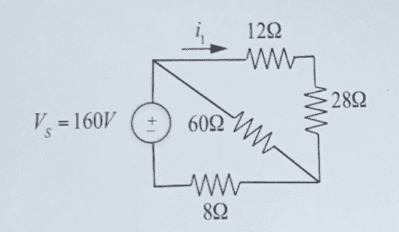

A) What's equivalent resistance of all four resistors?
B) What is current value of i1?
C) What is voltage across 60 ohm resistor?

Are you saying to use Kirchhoff's Voltage Law to find i1? In doing so, I get: -160+ 40i1 + 8i1 = 0 -> i1 = 3.33 A. Could I use a voltage divider to find the voltage across the 60 ohm resistor or no? FYI the loop was the outermost one.
Doing this for the 60 ohm resistor and choosing a loop as the lower left hand triangle, I get a voltage across 60 ohm resistor to be 120 V.

The current through the 8 ohm resistor is not i1, but rather it is iS = 5 A (the same as the current through the battery). Make sense?
With that equation fixed, you should be able to correctly calculate i1 to be 3 A.
I agree with your calculation of the voltage across the 60 ohm resistor: 120V.
One thing that helps me with circuit problems when a resistor is shown diagonally, is to re-draw it without the diagonal.
