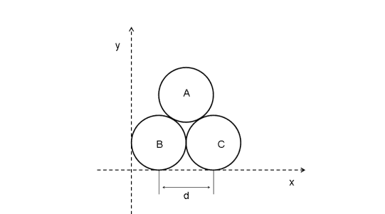

System S is static and is comprised of 3 identical metal pipes A, B and C which are placed so that A lays ontop of B and C. B lays into the y axis. The length of the pipes are orientated parallel with the z axis. The outer and inner radius of each pipe is (Outer : 0.51m) (inner : 0.50m) They have a length of 2m. The pipes are made of iron with a density of 37870kgm^-3
1) Find the X and Y coordinates to the System S.
2) what is the momment of inertia about the Z-axis

Hello Freshtone, :welcome:
Can you explain what you mean with
and perhaps post a drawing of the arrangement ?

Sorry about that!...ill copy a picture of the setup so you can see ! =) thank you for the replies already !
By saying B lays into the Y axis you can see here it is easier to see instead hehe.
By the z axis i think they mean that the pipes have a length of 2 meters going in the z axis which obviously is directly into the picture ...=)
Good. So we have the problem statement amost complete. What I'm still missing is: what is meant with
but I'm prepared to guess that they mean "the X and Y coordinates of the center of mass of the System S". Approved ?
So for 1. we need some math, nothing more. Except perhaps the relevant equation for the center of mass. See below.
But for 2 we really need something to help us find the moment of inertia, so we do need about two relevant equations. Any idea ?
In the mean time, working on 1: The center of mass (let's do the axis parallel to the z-axis on which the c.o.m. lies) of B is a giveaway.
And for C it's also a giveaway. A is only half a giveaway: the x coordinate is pretty clear. For the y-coordinate you need the fact that all three diameters are the same. And there are various possible approaches: the distance to the z-axis for A and C could well be the same, or you see an equilateral triangle when you think of the three pipe axes.
Top it off with the c.o.m. definition, which look up.

I have now "i think" worked out the first question at least...i used some trig to get the height on y-axis for A.
this was my work so far ... Xo=(7870*0.51+0.255*7870+0.765*7870) / 3(7870) and got Xo = 0.51m
my Yo was similar and i got the height from x up to A as 0.825m. so Yo = 0.445.
my x,y axis cords become (0.51 , 0.445) <-- this would be my answer to 1)
Can those sound right ? ...now I am working on finding second question and by so I am using Isz and working the area for the pipe so i can figure out the rest...Not sure i explainned that correct but maybe you see my point ?

If the three pipes are identical, then the center of mass is the geometrical center. And that would be the centroid of the equilateral triangle having the three centers of the pipes as vertices.
