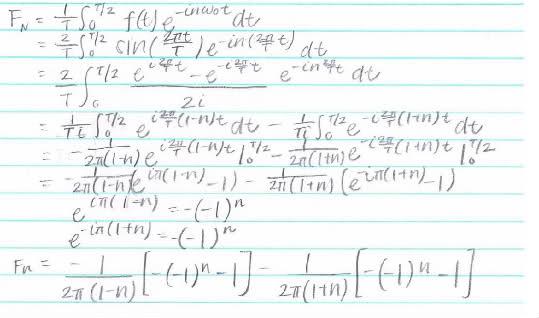

using f(t) = sin 2πt/T, i am getting infinity for F1
i got Fn = (-1/2pi(1-n))((-1)n - 1) - (1/pi(1+n))((-(-1)n - 1)
and plugging in 1, for the first part of the equation i am getting 0 in the denominator. i am also finding that for every odd n i am getting 0. this can't be correct, i assume?
Nope. You should find all the sine terms vanish since f(t) is an even function. If you can't figure it out, post more details of your calculation so we can see where the mistake is.
My calculations
You have to consider the cases for n=±1 separately. For example, when n=1, the integrand of the first integral is just 1, so the integral is equal to T/2.

is it possible to use the fact that Fn = 0 for odd n when f(t) = f(t+T/2)?? I'm not sure what you mean when you say you have to consider the cases for +1 separately since i thought the amplitude spectra is symmetric
when i do the coefficients for n = 3, 5, etc...i am getting 0
Sure. Why not?
i'm not sure what you mean when you say you have to consider the cases for +1 separately since i thought the amplitude spectra is symmetric
Simply put, you can't divide by 0, so the way you integrated was incorrect. You have to evaluate the integral differently in those cases. It's just like you can't say
[tex]\int x^n\,dx = \frac{x^{n+1}}{n+1}+c[/tex]
when n=-1. You have to consider the n=-1 case separately. The way you integrated works when n doesn't equal 1 or -1. For those particular cases, you have to evaluate the integrals differently.
