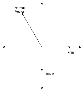

The dimension h is to be determined to that a worker can comfortably slides boxes weighing up to 106 lb up and down a frictionless incline. If the worker can apply a 50 lb horizontal force to the box, what is the largest value h should have?
Hint given: Before taking any other action, draw a FBD of the box. Isolating the box from its surroundings requires a closed surface passing between the worker's hands and the box as well as between the bottom of the box and the incline. It may be more natural to define and solve for an angle of inclination α and then determine h from tanα = h/6.
Picture and force body diagram attached
http://imgur.com/a/EBBCi
ΣFx=0
ΣFy=0
tanα = h/6
I am having a hard time differentiating between the force of 50lb along the ramp, and then the distance 6ft since they are not the same type of thing. Do I need to find the distance of the 50lb force? Or the force of 6ft? Because from there I could solve for α.
I am not sure if I am calculating a system that's in equilibrium since he is actively pushing the box up.

After having help on another problem I realize that the FBD should probably look something like this
Not sure where α would be located. I think it would be beside the normal vector in respect to the y-axis.
Finding the components of this I got
ΣFx=50-Ncos(α)=0
ΣFy=-106-Nsin(α)=0
However when I try to solve for α I get very strange numbers.

Check the signs in your equations.
Also, what you wrote about where alpha should be in your diagram was correct, but your equations tell a different story.
ΣFx=50-Ncos(α)=0
ΣFy=-106+Nsin(α)=0
Solving for them I got N to be ≈ 117.2 making α ≈ 64.7°

That is the correct solution to those equations, but did you see my edit to my last post? You wrote that alpha should be the angle between the normal and the y axis. That is correct, but it is not what your equations say.

They are, but you need to get them the right way round!
I find it helpful to check I have this right by considering the case where the angle is zero. When alpha is zero, will N act entirely in the X direction or the Y direction? Is that what your equations say?

No, when alpha is zero the ramp would be horizontal. That makes the normal force vertical, i.e. the y direction.
When alpha is zero, cos is 1 and sin is zero.

All I am asking you to check is whether you have sin and cos crossed over in your latest equations. I.e. should Nsin(α) be in the X equation or in the Y equation? When alpha is zero, that value will be zero.
ΣFx=50-Ncos(α)+Nsin(α)=0
ΣFy=-106=0?
I get that when the ramp would be flat it would have no y-component
Oh wait, so
ΣFx=50+Nsin(α)=0
ΣFy=-106-Ncos(α)=0
Solving for N and α= 117.2 and 25.25°?
Yup, I then solved for h and got it right. Phew.
