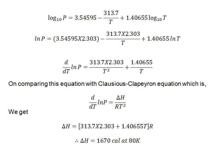

The vapour pressure of a certain liquid is given by the equation:
[tex]\log_{10}P=3.54595-\frac{313.7}{T}+1.40655\log_{10}T[/tex]
where ##P## is the vapour pressure in mm and T is temperature in kelvin. Determine the molar latent heat of vapourisation as a function of temperature. Calculate its value at 80 K.
I am really clueless about where to start. The liquid vapourises at a temperature when its vapour pressure is equal to the atmospheric pressure. I can calculate the boiling point from here but I don't think that would help here as I need molar latent heat of vapourisation as a function of temperature.
Any help is appreciated. Thanks!

Pranav-Arora said:
I checked the Clausius-Clapeyron equation on wikipedia.
[tex]\frac{dP}{dT}=\frac{L}{T\Delta v}[/tex]
But how am I supposed to find ##\Delta v## here? :confused:
This is a good start, but, with all due respect to Wikipedia, this is not the Clausius-Clapeyron equation. This is the Clapeyron equation. The Clausius-Clapeyron makes two additional assumptions:
1. The molar volume of the liquid is much less than the molar volume of the vapor
2. The vapor can be treated as an ideal gas.
When these additional assumptions are made, one obtains:
[tex]\frac{dP}{dT}=\frac{Lp}{RT^2}[/tex]
or, equivalently,
[tex]\frac{d\ln{P}}{d(1/T)}=-\frac{L}{R}[/tex]

Pranav-Arora said:
I don't see how would I get the ##log_{10} T## term.
Solving,
[tex]\ln P=\frac{-L}{RT}+C[/tex]
where C is some constant.
You can't integrate it this way because L is a function of T. You have to get L directly from the differential equation.
Thank you! That worked. :smile:

Brijesh Upadhyay said:
You do realize that the last response to this thread was 5 years ago, and the OP has not been seen since last October, correct?
Not to mention the fact posting full solutions is in general against forum rules.
