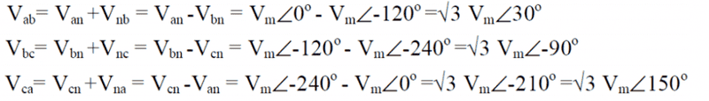

Assuming balanced 3 phase circuit and abc positive phase sequence:
The RMS value of line-to-line voltage between Phase A and C is V = 208∠10°
Find the line to line voltage between Phases A and B (magnitude + angle)
Find the line to line voltage between Phases B and C (magnitude + angle)
Determine the phase to neutral voltage Van, Vbn, Vcn ((magnitude + angle)
These were in my professor's notes:
I have no idea how to do this. Are the relevant equations I posted correct? Any hints would be appreciated.

Yes, but in these equations, VAN is assumed to be the reference phasor. In the question, you have Vac∠10° which means VAN is no longer the reference phasor. In a balanced three phase system, what is the phase difference between VAN and VAC? (Refer the equations you posted).

Yes. So what will be VAN when Vac=208∠10?

No. What is magnitude relationship between line and phase voltages?

Would it be 208/sqrt(3) = 120∠40?

No. Magnitude will not change but phase angle will.

So what would be Vac? Find Vac and use the relation between Vac and Van from your equations.

What is the angle between Vac and Vab? What is the angle between Vac and Vbc? Refer the equations again. But first find Vac from Vca.

No. Angle of Vca is 10°. What is the angle of Vac? Vac and Vca are anti-parallel phasors.

It's a 180 degree difference.

So:
Vca = 208<10°
Vac = 208<190°
Vab = 208<-110°
Vbc = 208<-230°
eehelp150 said:
Vac = 208<190°
If the angle of Vac=θ, then θ=180-angle of Vca.
Edit: I am imagining all this in my head without drawing it on paper and this is a mistake. Yes, angle of Vac is 190 degrees.

so
Vab = 208<-110
Vbc = 208<-230
Van = 120<190+30
Vbn = 120<(190+30)-120
Vcn = 120<(190+30)-240These correct?

Yes.
