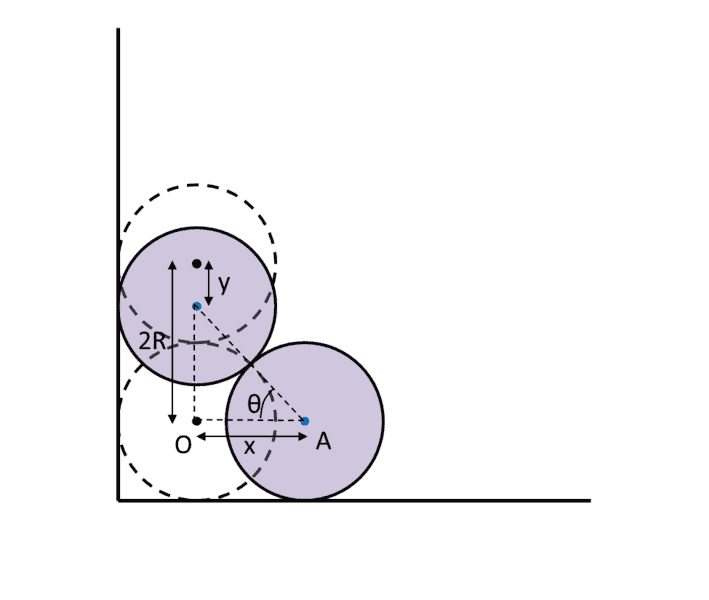

Two identical uniform cylinders of radius R each are placed on top of each other next to a wall as shown. After a disturbance, the bottom cylinder slightly moves to the right and the system comes into motion. Find the maximum subsequent speed of the bottom cylinder. Neglect friction between all surfaces.
See attachment for diagram
Let the final speed of the lower and upper cylinders be vb and vu respectively and their angular velocity be ωb and ωu.
Conserving energy
[itex]3mgR + mgR=\dfrac{mv_b ^2}{2} + \dfrac{mv_u ^2}{2}+\dfrac{mv_b ^2}{4}+\dfrac{mv_u ^2}{4} + 2mgR \\<br /> v_b ^2 + v_u ^2=\dfrac{8gr}{3}[/itex]
I have assumed that the cylinders do not slip on the surface and perform pure rolling. I need another equation as there are two variables.

Assume that lower cylinder shifts by a distance ##x## towards right and the top cylinder descends by ##y##. Can you relate the two?

But I would suggest a different approach. Let the CM of lower cylinder shift by ##x## and the CM of upper cylinder descends by ##y##. Let ##O## denote the initial position of CM of lower cylinder and ##A## and ##B## denote the position of lower cylinder and top cylinder at a later time respectively. Denote ##\angle BAO=\theta##. You get the following relations:
$$x=2R\cos\theta \Rightarrow \frac{dx}{dt}=-2R\sin\theta \frac{d\theta}{dt}$$
$$y=2R(1-\sin\theta) \Rightarrow \frac{dy}{dt}=-2R\cos\theta \frac{d\theta}{dt}$$
From energy conservation:
$$mgy=\frac{1}{2}m\left(\frac{dx}{dt}\right)^2+\frac{1}{2}m\left(\frac{dy}{dt}\right)^2$$
$$\Rightarrow 4gR(1-\sin\theta)=4R^2\sin^2\theta \left(\frac{d\theta}{dt}\right)^2+4R^2\cos^2\theta \left(\frac{d\theta}{dt}\right)^2$$
$$\Rightarrow \frac{d\theta}{dt}=\sqrt{\frac{g}{R}}\sqrt{1-\sin\theta}$$
$$\Rightarrow \frac{d^2\theta}{dt^2}=\sqrt{\frac{g}{R}}\frac{-\cos\theta}{2\sqrt{1-\sin\theta}}$$
For maximum speed, you have to equate ##d^2x/dt^2=0##. Can you proceed now?

I have attached a sketch. Let me know if that clears up the above issues.
Tanya Sharma said:
dy/dt is negative and there is already a negative sign in the RHS . Are you sure there should be an additional negative sign ?
Sorry, I was being hasty, you are correct in your analysis.
But I am little unsure about the sign issue. The problem with the signs and the messy algebra was the reason I switched to expressing everything with ##\theta##. I hope somebody else can clear it up. :P
Don't you think 'y' is the distance by which upper cylinder descends whereas we need distance by which COM of the system of two spheres descends ?
Why do you need the distance by which COM descends? :confused:
You can calculate the change in gravitational potential energy of individual spheres, no?

I chose to work with "x" instead of θ and here's what I got.
[itex]y=2R-\sqrt{4R^2-x^2}[/itex]
If you differentiate both sides you will get a relation between vx and vy. Next step is to use energy conservation.
[itex]3mgR = \frac{m}{2} (v_x^2 + v_y^2) + mg(R+\sqrt{4R^2-x^2})[/itex]
Note that I've not taken into account the GPE of the bottom cylinder since it does not change. Replace vy in terms of vx(using the relation derived earlier) and you will get an expression for vx in terms of x. For maximum velocity d(vx)/dx = 0.
