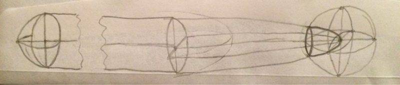

and it reminded me that another curiosity of mine is trying to find the optimal point along which one could pivot a drumstick, whose shape I will define as:
a relatively thin cylinder, with a half-sphere on the 'butt end', and on the other a paraboloid, whose tip is partially overlapped by a smaller shape- be it an ellipsoid, a barrel-esque shape (haha, burlesque), or a sphere. For the sake of argument it is made of an isotropic material.
Pencil sketch of a drumstick-like object: a sphere on the left, a cylinder with a rounded end in the middle, and a paraboloid tip with an overlapping ellipsoid or sphere on the right, drawn with latitude and longitude lines.
(This picture obviously does not use the correct proportions of scale, but I hope it gets the general point across)
I really don't have much experience with adding and subtracting volumes for computing that of a... object of 'composite shape'(?) (my words), but while the cylinder and half-sphere are quite straightforward, I'm pretty sure that in order to find the total volume for such an object I'm going to need to 1) subtract a spherical/ellipsoidal cap from the paraboloid, and 2) subtract the tip of the paraboloid from the sphere/ellipsoid.
I went ahead and wrote the volumes of each shape below:

It is not that complicated . Look up how to calculate volumes of solids of revolution .
nb : Divide solids of revolution with varying profile into short sections for easier calculations .
I understand. I could write a piecewise-defined 2-D equation r(x) describing the changing radius from 0 to L, take the indefinite integral, then multiply it by 2π.
Vstick = 2π * [integral;0,L] r(x) dx
However, I already have this information, and the integral would just result in the exact same ratios I'm about to add/subtract.
Here are some clarifying points about how each volume relates to each other:
rp = rc
rs,b = rc
hp = \frac{1}{2}hc
I have two problems though, the first is something geometric which I don't understand algebraically. The second is a simple decision I'll have to make.
1) If the tip of the paraboloid stops in the dead center of the sphere/ellipsoid, what is h (for the purpose of calculating the volume of the spherical/ellipsoidal and paraboloidal caps)?
2) Some times it seems as though the radius of the 'bead' (tip) of the stick is a bit smaller than that of the shaft (the main portion), and some times it's not that much smaller, so I would be tempted to say:
\frac{1}{2}rc =< rs,t =< \frac{2}{3}rc
