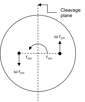

Perhaps I am not seeing something so please explain what it is. The picture below shows the sphere at the moment of the split looking down on the sphere. The rotation axis is perpendicular to the screen. At that moment the of the split the CM of the left hemisphere is moving down and the CM of the right hemisphere is moving up. Furthermore, the force that one hemisphere exerts on the other is zero (that's what a split means). So according to Newton's 1st law once the force between hemispheres is turned off, each center of mass at distance ##r_{cm}## from the axis of rotation will move in a straight line with the velocity it had just before the split. Did I misinterpret something?
I could be wrong (hence why I'm asking here), but the description you give seems to be valid only for the instant that the split occurs. The hemispheres should continue rotating as well as sliding immediately after they separate. Consider an orange thrown into the air which suddenly gets cut in two the way I described. You can imagine that the slices will continue to rotate (albeit more slowly) as they separate.
I think my point is best made in the following approach. A solid hemisphere of radius [itex]R[/itex] has its center [itex]\frac{3}{8}R[/itex] above the center of its circular face, so the two hemispheres must exert a force [itex]\frac{3}{16}mv^2/R[/itex] to maintain its centripetal acceleration (the CM is moving in a circle of radius [itex]\frac{3}{8}R[/itex]). At the moment of separation this force is set to zero. Applying Newton's 2nd law to each hemisphere dictates the angular velocity immediately after separation is unchanged; gradually, however, the normal force between the hemispheres slows down the angular velocity. If the hemispheres could pass through each other, I can see how they would travel in a straight line, but obviously they can't. I can definitely make this argument crisp, but it is tedious; suffice it to say the hemispheres must slide after separation.
I think what's happening in the energy-conserving ODE is that the sphere continuing to rotate as it did before separation conserves both [itex]J[/itex] and [itex]K[/itex], so there is no reason for the hemispheres to separate. I thought that maybe considering the hemispheres to rotate instantaneously about their CMs precisely at [itex]t=0[/itex] would help, but I'm not sure about that assumption.QM
