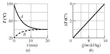

Samples A and B are at different initial temperatures when they are placed in a thermally isolated container and allowed to come to thermal equilibrium. Figure a gives their temperatures T versus time t. Sample A has a mass of 5.2 kg; sample B has a mass of 1.6 kg. Figure b is a general plot about the material of sample B. It shows the temperature change T that the material undergoes when energy is transferred to it as heat Q. The change T is plotted versus the energy Q per unit mass of the material.
The heat gained by object b must equal the total heat of object a. So Qb=Qa=Q/mb*mb, mb=mass of object b.
but Q=mcΔt ==> c=Q/mΔt would Δt then just be the total change from 100 to 60 degrees?
this would give me 25600/(5.2*60)=82.05 which is incorrect. Where Am I going wrong?
Thanks for the help
  • Two graphs: (a) temperature T in degrees C versus time t in minutes, curve A falling from 100 to about 40 and curve B rising from 20 to about 40; (b) change in temperature delta T in degrees C versus Q/m in kJ/kg, a straight line rising from 0 to 4 at 16.
I think it is better to replace the underlined by 'heat lost by'.
I think that you mean that [itex]\Delta[/itex]T is the change from 100 to 40, i.e. 60deg because we are considering A.
Can the poster explain what the above mean?
