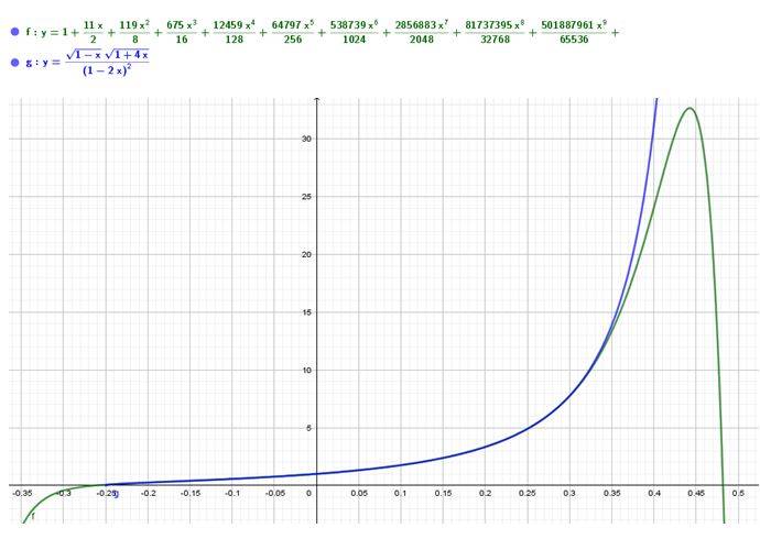

Anyway, your region ##-1/4 < x < 1/4## is partly correct: it is correct on one side, but too narrow on the other side. The actual convergence region is not symmetric about ##x = 0##.

Yes, it is true. The method I told you before is mistaken, so I gave you bad advice. Sorry.

A conundrum. A power series in x should have a symetric radius of convergence around the point of expansion (x=0). It should diverge outside of the radius. I guess that the substitution and rearrangement of terms changes the nature of the convergence.
The situation may be more complicated than that.
Certainly, a product of power series is convergent in the intersection of the individual convergence regions, so a sufficient condition for convergence of a product of series is ##|x| < R,## where ##R## is the minimum of all the individual convergent radii. However, that is not a necessary condition, so the actual convergence region of the product may be larger. For example, the three functions
$$f_1(x) = \frac{e^x}{1-x}, \hspace{2ex} f_2(x) = (1-x)^{1/4} e^x, \hspace{2ex} f_3(x) = (1-x)^{3/4}$$
all have radii of convgence equal to 1. However, their product is the series for ##e^{2x}##, which has radius of convergence equal to ##\infty##.
