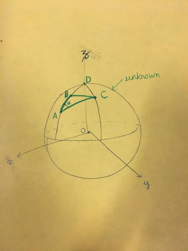

I have three points: A, B and C, which are all on the surface of the same sphere.
I need to find the xyz coordinates of C.
What I know:
- the radius of the sphere
- the origin of the sphere
- the xyz coordinates of A and B
- the arc distance from A to C and from B to C
- the angle between AB and BC
Any ideas?
Thanks!

Doing this on the sphere is proving to be more difficult because it would require me to have the azimuth and the polar angles of my point C, whereas all I have is the angle between AB and BC on the surface of the sphere.
d70YXW7
In the image attached, you can see that I know the length of AB, BC and AC. I know the angle alpha. I don't know any other angles. I know the xyz coordinates of A and B. I DO also know the xyz coordinates of point D, which is on the z-axis.
  • Hand-drawn sketch of a sphere with origin O, axes x, y and z, and a spherical triangle ABC in green with points A, B, C and D on the surface; angle alpha is marked at A, and the label unknown points to the sphere surface.

That is for the case of rotation around the origin by angle theta. In the OP problem the angle alpha is not at the origin. It is the angle between two line segments AB and BC, neither of which is known to go through the origin or to point towards it.
What you really need is the equation that describes the circle and sphere.
