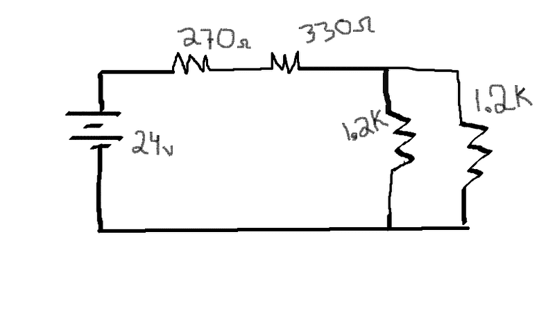

Find the current and the voltage across each resistor.
volts is 24v
R1=270 ohms
R2=330 ohms
R2=1.2k ohms
R4=1.2k ohms
This is not a homework its more like a study guide.
He gave us the answer for just the currents which are
IR1=20
IR2=20
IR3=10
IR4=10
But not sure how he got that.
this is what i did but don't know how to go from there:
(270+330)|| (1.2k||1.2k)
600||600
R=300
  • Circuit schematic: a 24 V battery in series with a 270 ohm resistor and a 330 ohm resistor, then two parallel branches, one labelled 1.2K and one labelled 1.2K, closing back to the battery.
Having reduced the (1.2k||1.2k) to an effective 0.6k, what is the relationship of that in the circuit to R1 and R2?
ahh yes there was the problem,after 1.2 k and the other 1.2k were combined it becomes one resistor in series with the (r1 and R2). Thanks!
