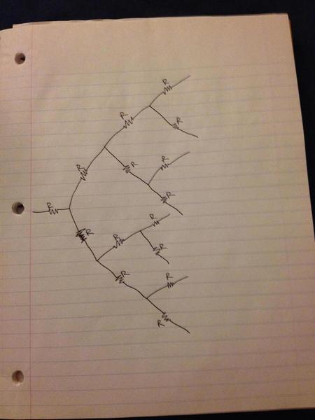

1. A) Find the Effective resistance of a tree of resistors that bifurcates 3 times.
B) Find the effective resistance of a tree of infinite resistors. (if the tree below went on to infinity)
Ohm's Law
I have no idea how to start this. There was no other info given either.
Surely you can draw the 3-bifurcation one to completion and solve it? At least give it a try.
is it just resistors in series ?
Let's denote the resistance of that whole tree as T ohms. We don't know what it will be, yet, but at least we have given it a symbol.
Wherever you look, you find sub-trees that are all identical to that parent. So in place of each of those sub-trees going off to infinity you can substitute a single resistor of value T ohms. This simplifies the figure considerably! !
So there's 7 T ohms + R ohms
im just having a hard time seeing if they are in series or parallel
I think you mean 8? These will all be going to ground at their farther end.
See whether you can do it using fewer than 8.
is the answer 15R/8 ohms?
and for part b would it just be 1 since there's a infinite number of resistors and bifurcations?
For (a), yes.
You're guessing. ✗[/size][/color]
The resistance is going to have to be at least R.
Good job !
NascentOxygen said:
You're guessing. ✗
so the answer to part b is R ohms because it would be infinity over infinity?
If you want to really get a sense of what's going on, do it for 1 branch, 2 branches, 3 branches (already done), and maybe 4 branches and see if there is a pattern that you could extrapolate to a limit.
oh ok. so its 2R ohms since is approaching 2R ohms. The next branch added would be 31R/16
Again, good job !
