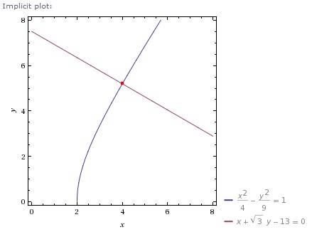

Here is a plot of the hyperbola and the normal line at the given point:
