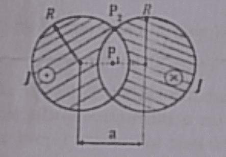

In the system shown in the picture, there's a current whose constant density is J=0,5A/mm^2. System contains two pieces as shown in the picture, in the area where two pieces intersect, there's no current. If R=1mm and a=1,25mm (a - distance between centers of the circles), find the vector B in at points P1 and P2.
Diagram of two overlapping circles, each shaded with diagonal hatching, with the lens-shaped overlap left unshaded; points P1 and P2 are marked on the figure, and a horizontal dimension a is shown between the circle centers.
Biot-Savart law
I think i should solve this using superposition, or even better, find the B for the first part and multiply it by two in both cases (P1 and P2) since i should get the same value for both parts of the system. Now, i could think of the first part as lot of lines with current flowing through them, then i could sum up (integrate) all lines in that area and find the value B. The problem is, how to find area?

In looking at you image enlarged, it appears that the current flows in opposite directions in the two shaded regions.
Diagram of two overlapping circles of radius R, centres separated by distance a, with the overlap lens unshaded; the left circle is hatched with J out of the page (dot) and the right with J into the page (cross), points P1 and P2 marked.
In the region on the right J is into the page. On the left,J is out of the page.
Therefore, the net current flow is zero.

Do you need to use the Biot-Savart law? If not use Ampere's law along with superposition to make the solution fairly easy.
Consider this as two overlapping circles (actually circular cylinders). Each has current density J, the left with J out of the page, the right with J into the page.

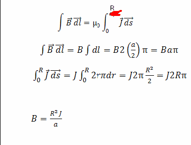

Using Ampere's law, for the P1 i got ∫Bdl=μ0∫J*dS
for the left part: ∫Bdl=B2rπ (r is the distance from center to the P1 -it's a/2)
for the right part: μ0∫J*dS= μ0*J∫2rπdr (limits of integration are 0 to r) =μ0*J*r2*π*2
so B=μ0*J*r2/2
Doing this for the second part i got the same solution just opposite direction (minus sign), which means B is zero, which is wrong, but i don't see any mistakes. What is incorrect here?
so B=μ0*J*r2/2
For P1:
You had indicated previously that the contribution from the left conductor is in the same direction as that from the right conductor. Have you abandoned this?
Are you going to plug-in a/2 for r or not. sometimes you do sometimes not.
What are the integration limits for ##\displaystyle \ \int \vec J \cdot \vec{dS} \ ## what is r? In fact, since ##\ \vec J \ ## is constant, why use an integral at all?
You have made algebra errors in solving for B.​

This is how i did it for the P1, but i still don't understand how to find B for the second part, i know it should be in the same direction and it should have the same intensity, but how can i know that the part where they intersect is not included here, i mean if i go and calculate B for the second part i don't see how part where they intersect is not included, and if radius on the right side of the equation is a/2 again (and i think it is, because that is the distance from center to point whose B i am looking for), but if distance from center is a/2 that doesn't mean that the two parts are placed exactly like in the picture, i mean, there could be more (or less) intersected area and still these limits of integration and radius would remain the same.
For Ampere' Law. how are the path for the line integral and the region for the surface integral related ?
In this case, left side is circumference of the circle and area of the same circle is the right side of the Ampere's law, correct me if i am wrong.
cdummie said:
In this case, left side (of the equation) is circumference of the circle and area of the same circle is the right side of the Ampere's law, correct me if i am wrong.
Yes. So that's a/2, not R.

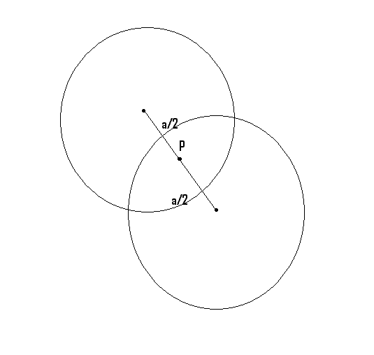

I mean, while calculating B i integrated like i have a full circle, but there's intersection with no current, if i do the same thing for the second part, how can i be sure that intersected part is not included if i calculated both times as if i have a full circle, i mean, will intersected area remain the same if two cylinders are placed, for example, like this:

That will change the direction of the B vector, but that's all.
Don't forget, you're using super-position to get the overall answer.

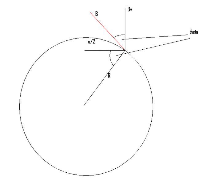

Well, since i got B=μ0JR/2 and if θ is angle between vertical component of vector B and vector B then Bvertical=Bcosθ , but i don't see how this can be related with a.
Can you express cos(θ) in terms of R and a ?
Well, if θ is angle between Bvertical and B then angle between Bhorizontal and R (R to the point P1) is also θ since the sides of those two angles are orthogonal so cosθ can also be a/2R so Bvertical=B*cosθ=(μ0JR/2)*(a/2R) so Bvertical=μ0J*a/4
and if i multiply this by i have the solution for P2 since i should get same solution for the second part so B=μ0J*a/2. Correct me if i am wrong.
You should use parentheses adequately. (a/2)/(R) is what you apparently intended.
a/2R = (aR)/(2) ≠ (a/2)/(R)​
(a/2)/(R) can also be written as a/(2R) .
More importantly, that's not the correct expression for cosθ. That's sinθ, not cosθ .

The way i see it, i don't understand how that is sinθ, which means i maybe made a mistake and i don't see where, so here's the picture (as for the parentheses part, i see, thanks that's what i meant):
Geometry diagram of a circle of radius R centred at the origin, with a point on its edge where a red line B, a vertical line Bv, a horizontal line labelled a/2, and a line labelled theta meet at an angle from the radius.
B is tangent to the circle, thus B is perpendicular to the radius line.
