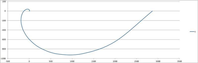

I'd like to know if it is possible to find the pitch a log spiral knowing that at every round (2π) r grows by 535.5 times.
For the little I know the equation should be just r = e = 535.5
Supposing it starts at r=1cm and goes clockwise, I have guessed that its length should be 755.88 cm. and pitch=45° ,
but according to Torricella formula pitch should be ≈44.85°, since the whole length should be ≈ 759 cm and [itex]\varphi[/itex]= ≈45.15°
so that 535.3/cos[itex]\varphi[/itex] =759 cm and 759-755.9 = 3 cm which is too much for the curve from 1 to 0, isn't it?
Can anyone make a graph?
Thanks a lot.

A picture of one turn looks like an ear on it side. Any subsequent turn is almost completely similar (preceding turns are so small they disappear in the dot at the origin).

b is 1, arctan 1 = 45°, that need no calculator but I was not sure about b!
I had reached that conclusion by logic, and also made a graph and saw the angle (pitch) is rougly 45°,
but, as I explained, the Torricelli formula for the whole curve led me astray.
