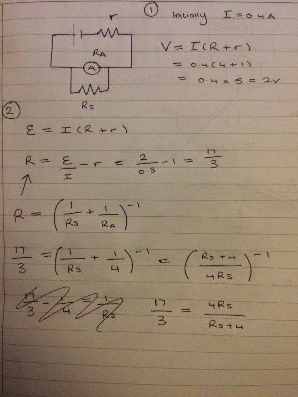

Work out the resistance of shunt placed in parallel to ammeter
emf, E = I(R+r)
How would I go about this question?
Here is my attempt at it but I haven't really gone anywhere with this :oldconfused:
Any help would be really appreciated!
Bolter said:
Homework Statement:: Work out the resistance of shunt placed in parallel to ammeter
Relevant Equations:: emf, E = I(R+r)
From where you got to, you can just multiply out and collect the Rs terms together.
However, the answer it gives is clearly wrong. It is because you took the 0.3A as being the current through the main circuit. Reread the question.
Firstly, I don't like your use of R and E without saying what they are. Is E the same as V, the battery voltage?
Both for your sake and ours, be clear what letters/symbols refer to.
1 is fine, at least, if it's to find the battery voltage.
2. What are you doing now? I guess R is the equivalent resistance of the meter with the shunt in place.
But, as Haruspex says, you don't know the current now. You know the current through the meter decreases from 0.4 A to 0.3 A, but some current now flows through the shunt - and you don't know how much.
What you need is a bit more info:
If the current through the meter has reduced and the meter internal resistance is the same, what else must have changed?
So does the total current still remain as 0.4 A?
And then when total current reaches the 2 branches in parallel with each other, current gets split.
Where 0.3 A flows through the ammeter and 0.1 A flows through the shunt resistor.
I know that voltage is the same across each branch in a parallel combination. So the ammeter has resistance 4 ohms and current 3 A, therefore V = IR = 0.3 * 4 = 1.2 V
Hence Rs * 0.1 = 1.2 V so Rs = 12 ohms (Rs = resistance of shunt resistor)

The voltage drop across the ammeter?
Right. Sorry I didn't see your previous post.
If the voltage across the ammeter has dropped, then the current won't still be 0.4 A
Is it safe to say that 0.1 A will flow across the shunt and 0.3 A across the ammeter?
No.
If the voltage across the ammeter and shunt has dropped, then if 0.4 A still flowed, there would not be enough voltage drop across the battery internal resistance.
Work out what the voltage was originally across the meter, then what will the new voltage across the meter be?
Voltage originally across the meter is 1.6 V as the emf was 2V, lost volts came out to be 0.4 V therefore the terminal pd across the meter has to be 1.6 V
New voltage across the meter can be found by simply using ohm's law, so V = IR = 0.3 * 4 = 1.2 V
Now you can get the new current through the battery
Wait so if I know that battery emf is 2V and that 1.2V is across the shunt and ammeter? Then lost volts through the internal resistance of the batter is 0.8V
I = v/r = 0.8/1 = 0.8 A so new current has increased?
Yes. Because you have reduced the overall resistance of the circuit.
I see, but how does this new battery current help us find the shunt resistance?
So now I'm I correct to say that if the main current happens to be 0.8 A, then 0.3 A passes the meter and 0.5 A passes the shunt, where the 2 individual currents across each branch must sum to the total current 0.8 A
So using ohm's law again. 1.2V = 0.5A * Rs
Giving Rs = 2.4 ohms?
That's what I got.
