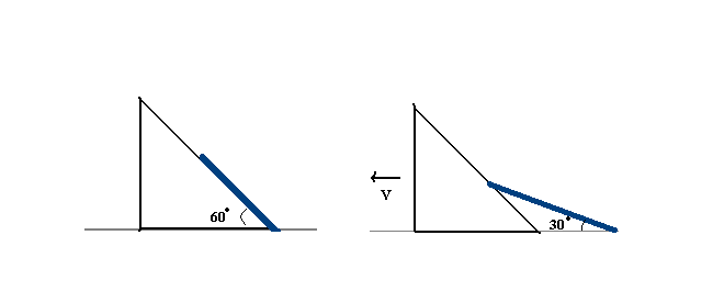

A thin rod of mass m = 1 kg and length l=1m is placed along the hypotenuse side of a wedge lying on a frictionless floor having mass M =5kg and angle 60° . At t= 0 the system is released from rest. Both the objects are free to move .Find the speed of the wedge when the rod makes an angle 30° with the floor.
Let V be the speed of the wedge and v be the speed of the CM of the rod .
Applying conservation of momentum MV = mvx
Applying energy conservation (mgl/2)(sin60° – sin30°) = (1/2)MV2+ (1/2)mv2+ (1/2)Iω2
Not sure how to proceed. I guess we need to find some constraint relation .
I would be grateful if somebody could help me with the problem.
Right.
Hint: The upper end of the rod remains in contact with the surface of the wedge. That should give you a relation between a certain component of the velocity of the wedge and the same component of the velocity of the upper end of the rod.

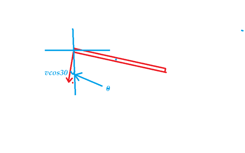

Thanks for the response ,TSny .
Component of velocity of the upper end of the rod perpendicular to the hypotenuse face = Vcos30° .
But how do I find the component parallel to the face ? How does that help us in determining the velocity of the CM of the rod ? I guess I need to find the x-component of velocity of CM of the rod .

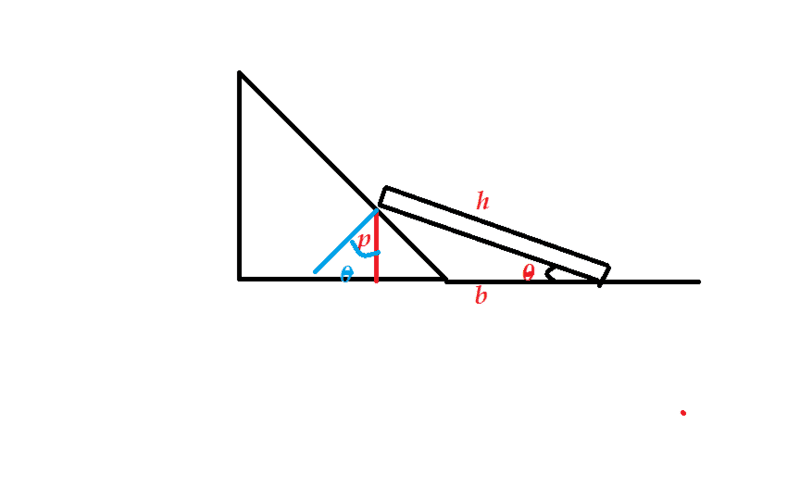

The velocities of wedge and rod perpendicular to the to the contact surface should be same.
So Vcos60=vcos30
Is it right?

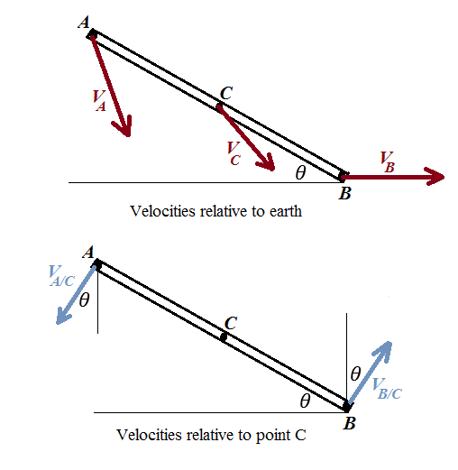

Can you use the constraint at the lower end of the rod to help you express the y-component of the CM in terms of ω? It is helpful to remember the relative velocity formula ##\vec{V}_A = \vec{V}_C + \vec{V}_{A/C}## for any two points A and C of the rod. Think about the points you might choose for A and C.
Yes.
If I consider the upper end of the rod and the Center then the only useful information we have is the component of velocity of upper end perpendicular to the face of the wedge .
Also , not sure how the component of velocity of the upper end we have calculated is useful for us ?

Combine these. That is, if you let A be the upper end of the rod and C be the CM, what do you get if you combine ##\vec{V}_A = \vec{V}_C + \vec{V}_{A/C}## and the constraint equation for A?
## \vec{V}_A = (\frac{M}{m}V+\frac{l}{2}ωsinθ)\hat{i} ##
Is it correct ?

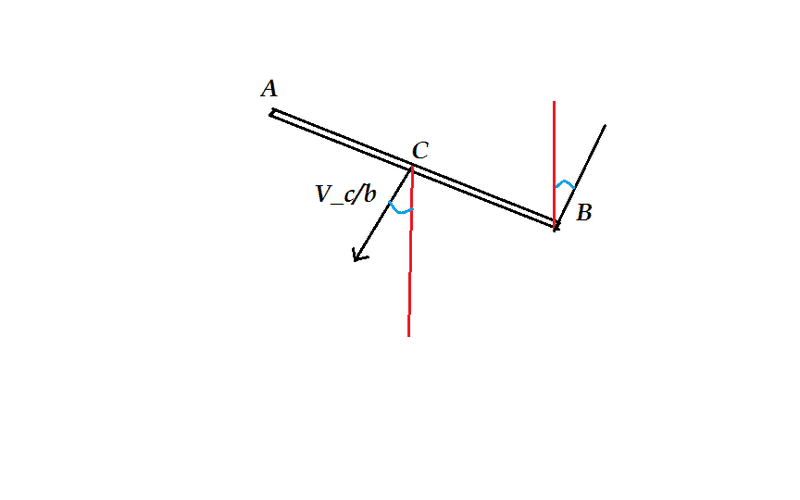

## \vec{V}_A ## should have both x and y components. Are you taking ##\hat{i}## to point to the right?
We've got a lot of variables. For now, just express the Cartesian components of ## \vec{V}_C## as ##v_x## and ##v_y##. Express the Cartesian components of ##\vec{V}_{A/C}## in terms of ##\omega## and ##\theta##. Then you can express ## \vec{V}_A ## in terms of ##v_x## , ##v_y## , ##\omega## and ##\theta##.
##\hat{i}## to the right and ##\hat{j}## upwards .
## \vec{V}_C = \frac{M}{m}V\hat{i} + \frac{l}{2}ωcosθ\hat{j}##
## \vec{V}_{A/C} = \frac{l}{2}ωsinθ\hat{i} + \frac{l}{2}ωcosθ\hat{j}##

Close. But I think there are several sign errors. Does the CM have an upward y-component of velocity? Reconsider the direction of ##\vec{V}_{A/C}##.
Doesn't the negative value of ω make the y-component of velocity negative ?
OK. I didn't notice that you were taking clockwise as positive rotation.
[But it seems less confusing to me to take CCW as positive rotation for this problem.]

You now have ## \vec{V}_A = V_{Ax}\hat{i} + V_{Ay}\hat{j} ## with explicit expressions for ##V_{Ax}## and ##V_{Ay}##.
You need to consider the component of ##\hat{i}## perpendicular to the wedge and likewise for ##\hat{j}##. The coefficients of ##\hat{i}## and ##\hat{j}## will just go along with the ride no matter what their signs.
Do you agree that ##\hat{i}## makes angle 150° with the perpendicular to the wedge (pointing inwards) and ##\hat{j}## makes angle 120° ?
Yes.
Are you getting $$\sqrt{\frac{15\sqrt{3}-1}{142}}$$
