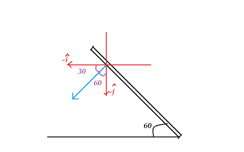

  • #38
Satvik Pandey said:
I was unable to understand how you find V[itex]_{C}[/itex]and V[itex]_{A/C}[/itex]
I tried to understand your solution but it is a bit difficult.I tried this.
Let the rod rotate along CM
So,Vcosθ=lω/2
velocity of this component in y direction=lωcosθ/2
So V[itex]_{A}[/itex]=-MV/m##\hat{i}##-lωcosθ##\hat{j}##
Is it right?I also have some sign error. I am unable to find V[itex]_{A/C}[/itex]?-
Here is the figure.
  • #39
So,Vcosθ=lω/2
Your y component of V[itex]_{A}[/itex] looks correct if ω represents the magnitude of the angular velocity (i.e., a positive number). However, the x-component is not correct. The equation Vcosθ=lω/2 is also not correct.
We have the relative velocity formulas $$\vec{V}_A = \vec{V}_C + \vec{V}_{A/C}$$ $$\vec{V}_B = \vec{V}_C + \vec{V}_{B/C}$$ where A is the upper end of the rod, B is the lower end of the rod, and C is the center of mass of the rod. See the attached figure.
Can you express the magnitudes of ##\vec{V}_{A/C}## and ##\vec{V}_{B/C}## in terms of ##\omega##?

  • #40
If the rod rotates around the CM of the rod then by v=rω
V[itex]_{A/C}[/itex]=lω/2 (Considering CCW as +ve)
V[itex]_{B/C}[/itex]=-lω/2
But how can we say that directions of V_A/c and V_B/C are perpendicular to the rod(from figure in#39) ?
It seems to be correct but are there any proofs.
  • #41
Relative to C, all the points of the rod move in circles around C. The velocity of a point moving in a circle is tangent to the circle, and therefore perpendicular to the radius of the circle.
Yes, the magnitudes of ##V_{A/C}## and ##V_{B/C}## are each equal to ##l\omega/2##.
Can you express the x and y components of ##\vec{V}_{A/C}## and ##\vec{V}_{B/C}## in terms of ##l##, ##\omega## and ##\theta##?

Satvik Pandey said:
On putting M=5kg,m=1kg,l=1m, θ=30 and I=ml[itex]^{2}[/itex]/12.
I got
[5V-[itex]\frac{ω}{48}[/itex]][itex]\hat{i}[/itex]-[itex]\frac{√3 ω}{24}[/itex][itex]\hat{j}[/itex]
According to wedge constraint the velocities of wedge and rod perpendicular to the to the contact surface should be same.
Velocity of wedge perpendicular to the contact surface is Vcos30
Velocity of A perpendicular to the contact surface=[5V-[itex]\frac{ω}{48}[/itex]]cos150 [itex]\hat{i}[/itex]-[itex]\frac{√3 ω}{24}[/itex]cos60[itex]\hat{j}[/itex]
Could you explain the above expressions ?
  • #59
I tried to find the velocity of upper part(part A) of rod perpendicular to the contact surface.
I resolved the rectangular component of V_A in the direction perpendicular to the contact surface and then I wrote them together.
Is it right?
