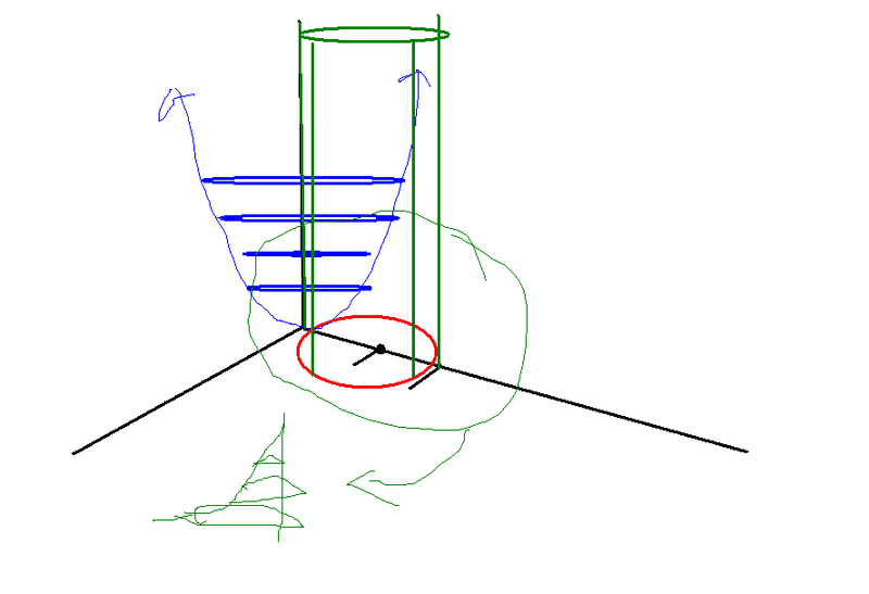

Compute the volume of the indicated solid
Below z = sqrt(x^2+y^2), above z = 0, and inside x^2 + (y-1)^2 = 1
My professor solved this in class but I didn't understand why deta is from -pi/2 to pi/2.
It is obvious that the region D for integration is the trace of x^2+(y-1)^2 = 1
In xy-plane it's a disk whose center is at (0,1)
Since this is not a unit circle at (0.0), my professor said we have to express this disk in polar form, and I can't tell what the reason is. Maybe we want to find the range for the angle and radius?
x^2 + (y-1)^2 = 1 in polar form
x^2 + y^2 - 2y +1 - 1 =0 > r^2 -2rsin(x) = 0 where x is deta
r^2 = 2rsinx
r = 2sin(x) this is the polar form for x^2 + (y-1)^2 = 1
Integration region D in polar form: {(r,x): 0 <= r <= 2sinx , -pi/2 <=x <= pi/2} and I know the integrand is r (polar form for sqrt(x^2+y^2) )
Why is it -pi/2 and pi/2? How can I tell when the problem varies?
Thank you.

You could let the angle go from 0 to pi, if that's your question, and you'd get the same answer. You just need an interval for the angle which will trace out the entire circle.
Yes. But I would like to use polar before diving into clindrical.
But how did you see it's 0 to pi, or -pi/2 to pi/2
I can't figure it out.
Thank you.
Well, to find a volume, you need a three-dimensional coordinate system, which means cylindrical, not polar, but cylindrical is just polar plus the z coordinate.
To find the necessary range of θ, just plot the function r=2 sin θ, and see what values work.

from 0 to pi, we get exactly what we have in rectangular, x^2 + (y-1)^2 = 1, whose center is at (0,1) with radius = 1
but how is it -pi/2 and pi/2
i don't think 0 to pi will give me the same answer as from -pi/2 to pi/2
answer from wolframalpha
integrate r^2 dr dx, x = 0 to pi, r = 0 to (2*sin(x)) -> 32/9
integrate r^2 dr dx, x = -pi/2 to pi/2, r = 0 to (2*sin(x)) -> 0This is the solid...

Try plotting the function letting θ run from -pi/2 to pi/2. You'll get the same circle.
Why are you integrating r2 dr dθ? That's not the volume element in cylindrical coordinates.

Yes, you're right. I had done it as a triple integral in Mathematica, and I get the same results for both ranges of angle. Let me look into what's going on a bit more.
There's a complication from using the interval -pi/2 to pi/2 for θ because from -pi/2 to 0, r=2 sin θ is negative. That means the height of the volume z=sqrt(x2+y2) isn't simply r, but |r|. The integrand should therefore be r |r|. If instead you integrate from 0 to pi, r will be always be positive, so you can simply integrate r2 to get the answer.
Considering this, it seems strange your professor would opt to use -pi/2 to pi/2 instead of 0 to pi unless it was to illustrate this point.

Note in the plot below, we're looking at it with the x-axis at the left side. Now, you derived the expression for r as a function of t: [itex]r=2\sin(t)[/itex] and from the picture, t clearly goes from zero to pi (since the circle is above the x-axis) or just 2 times from zero to pi/2 since it's symmetrical on both sides. So looks to me it's just:
[tex]V=2\int_0^{\pi/2}\int_{0}^{2\sin(t)} (r) rdrdt[/tex]
I think the -pi/2 thing was not correct.
