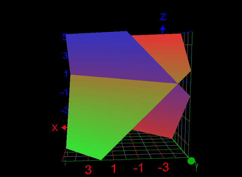

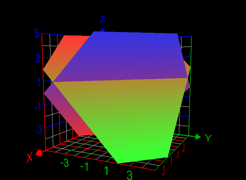

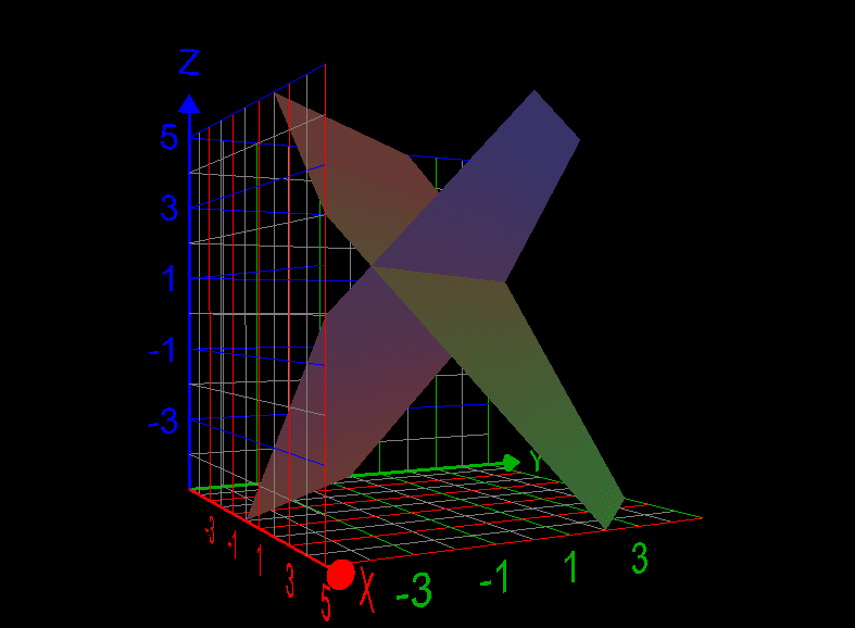

My graphing calculator sketched this problem as follows:
3D plot of a solid bounded by surfaces in x, y and z, with axes labelled X, Y and Z, z-axis ticks at -3, -1, 1, 3 and 5, and x-axis ticks at -3, -1, 1 and 3, shown in red, green and blue shading.
3D plot of several colored planar surfaces on a grid with axes labeled x, y and z, showing a solid region bounded by intersecting planes; tick labels include 3, 1, -1, -3 on x and 5, 3, 1, -1, -3 on z.
3D plot on black background with x, y and z axes, grid lines and tick labels; two translucent planar surfaces, one reddish-brown and one blue-green, intersect and form a wedge-like shape.
Now, which volume, the author want to be computed by readers, viewers and/or students?
The graphs from your calculator aren't very helpful. The sketch I drew on a piece of paper shows that the solid lies entirely in the first octant (the portion of space in which all three coordinates are nonnegative).

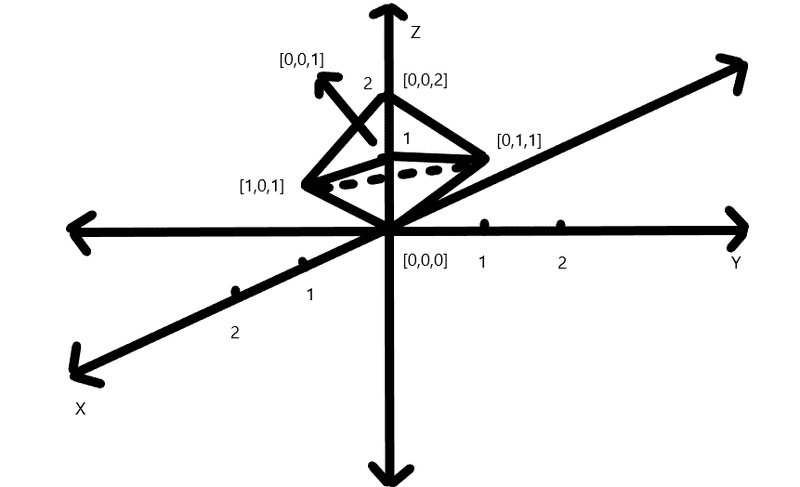

The vertices of the upper tetrahedron are at (0, 0, 2), (1, 0, 1), (0, 1, 1), and (0, 0, 1). Notice that the first three of these vertices lie on the plane z = 2 - x - y. The vertices of the lower tetrahedron are at (0, 0, 0), (1, 0, 1), (0, 1, 1), and (0, 0, 1). The first three of these vertices lie on the plane z = x + y.

Hi,
Is the following sketch as per your vertices correct?
Hand-drawn 3D coordinate axes with X, Y and Z labelled, a solid with vertices labelled [0,0,0], [0,0,2], [0,1,1], [1,0,1] and [0,0,1] drawn on the axes, with tick marks 1 and 2 on each axis.
WMDhamnekar said:
Hi,
Is the following sketch as per your vertices correct?View attachment 301525
Yes, that looks like what I did. I haven't worked the problem, but I think you'll need the equation of the line that goes from (1, 0, 1) over to (0, 1, 1). This should be x + y = 1, in the plane z = 1.
Sothe final answer to this question is ## \displaystyle\int_0^1\displaystyle\int_0^{1-x} (2-2x-2y) dy dx = \frac13 ##
