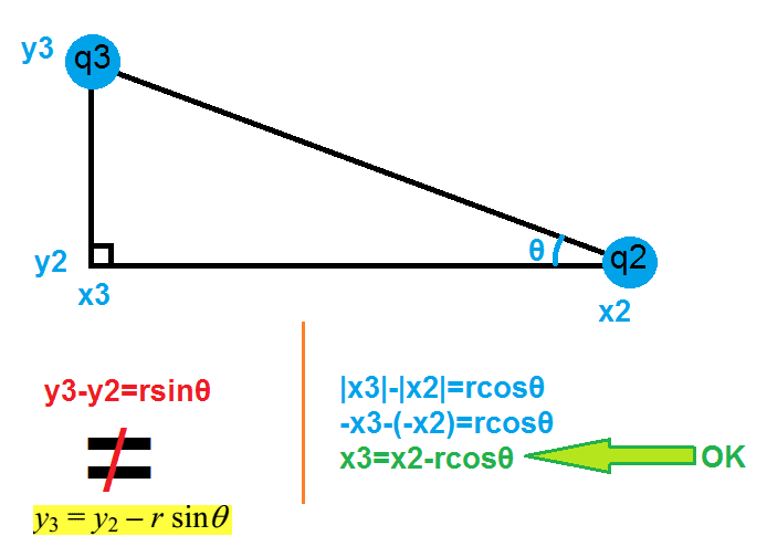

OK, I've progressed a bit. Now, I don't know why there is also a negative sign before rsinθ in y3=y2-rsinθ.
Right triangle with q3 at top left, q2 at right, right angle at x3,y2 corner, angle θ at q2; below, y3-y2=rsinθ crossed out with ≠ and y3 = y2 - r sinθ; beside it |x3|-|x2|=rcosθ, -x3-(-x2)=rcosθ, x3=x2-rcosθ marked OK.

What does the book solution state in parentheses immediately after that? Does that accord with the way you have drawn θ?
So it means that the negative sign is because of the fact that sin(-θ)=-sin(θ)?
Theta is the angle wrt the negative x-direction. That's all.
Yes.
They define θ as the angle the vector from q3 towards q1 makes to +ve x axis. By convention, that would mean anticlockwise from that axis. Your diagram shows θ measured clockwise from the axis, so your θ is minus their θ.
