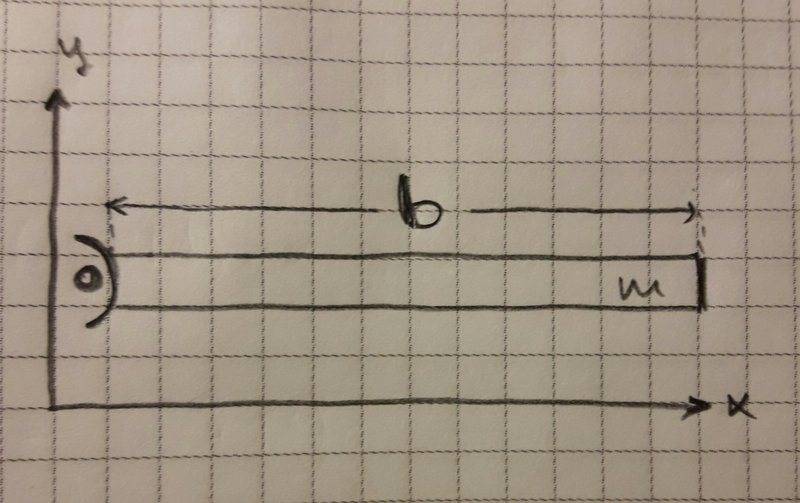

Hi. I ve got a problem, where I have to show torque by integrating the weight of the rod over the whole it's length.
[/B]
Result, what I am suppose to get is:
## \tau_{rod} = \frac{mgb}2 ##
[/B]
When I try to integrate, I am only getting:
## \tau_{rod} = \frac{mgb^2}2~~~~ ##
I'm sure I'm doing some silly mistake. But why can't I do this:
## \frac{d \tau_{rod}}{db} = mg~b~~~~~~⇒~~~~~~ \int \,d \tau_{rod}= mg \int b\,db~~~~~~⇒~~~~~~ \tau_{rod} = \frac{mgb^2}2~~~~##??
I only get the right answer by doing this:
## \frac{d \tau_{rod}b}{db} = mg~b~~~~~~⇒~~~~~~ \int \,d \tau_{rod}b= mg \int b\,db~~~~~~##
but I don't really understand why should I be doing anything like that, and this seems to me like completely wrong approach.
Im sorry if this seems very stupid :/

If you have mass element ##dm## at distance ##x## from the the pivot, then the element contributes torque ##d\tau = dm~x##. The next thing you have to do is add up (integrate) all such elements over the length of the rod. Note that both ##dm## and ##x## are variables. You need to invent a linear density and cast ##dm## in terms of ##dx##.
b is the whole length of the rod. That is a bound on the integral, but not the variable of integration. Create a separate variable for that to avoid confusion.
In particular, you may find you are confusing mass with mass-per-unit-length.

OK! I think I got this now... Please confirm if I am doing the right thing...
lin.density = ##\frac mb##
##dF=g \int_0^b \,dm##
## g \int_0^b \,dm = \frac {mg}{b} \int_0^b \,dx##
## g \int_0^b \,dm =g~dm= dF##
##g~dm~x = d\tau##
##d\tau=\frac{gm}{b}\int_ 0^b x\,dx##
##d\tau=\frac{gm}{b}[\frac{x^2}{2}]_0^b##
##\tau=\frac{gmb^2}{2b}=\frac{gmb}{2}##
Cooojan said:
##F=g \int m'\,dm##
Imagine cutting up the rod into length elements ##dx##. If ##m'## is the linear density, then what is mass element ##dm##? If I give you length ##dx##, how much mass is in that length?
Also, we are not looking for a force, we are looking for a torque. Please reread post #2.
Since we don't deal with volume here, but only length, so lin.density should be ##=\frac mb##..
And as I understand, the mass per length ##dx## must be ##\frac{m}{dx}##.. And torque is just the the force time radius times ##sin\theta##,
so in this case, I thought I could multiply both sides with that particular ##x##, to get that particular ##\tau##
Im sorry if that's annoying...
Cooojan said:
Since we don't deal with volume here, but only length, so lin.density should be ## \frac {m}{b}##.
That is correct.
Incorrect. We already decided what the linear density is. Linear density is also known as mass per length. Units might be kg/m.
Perhaps you can clarify these ideas in your head if you answer this "real-life" situation: Given a salami of length b = 1.0 m and mass m = 2 kg, what is the mass, dm, of a slice of length dx = 3×10-3m?

Cooojan said:
t all suddenly became very clear, when u put it in salami terms...
I'm glad. Can you finish the problem now?
