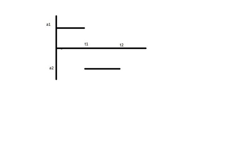

the problem goes like this
YOu are asked to start from rest, go a distance L=105 m and end up at rest again all in minimum time. Your vehicle has a maximum acceleration of a1 and maximum braking of a2. Determint t1, t2 and maximum speed. a1=7.5m/s^2 , a2=-10 m/s^2. The plot of acceleration versus time is attached
I have attempted the solution using the veocity equations but i have 3 unknows the velocity and the times. Tried deriving an expression for accelertionand elocity but not getting it. stuck how to go ahead. Please help

Show us what you did so far, please.
till t1 i found the velocity as 7.5t1 and from t1 to t2 the velocity as -10 (t2-t1). I don't know how to go ahead from this

Good. Ok. The one other equation I'd like to see is distance versus time. Question before we begin: Is that 105 m the distance covered during t1, or is it the total distance covered from start to stop?
Chet
Well that is what I qm confused about... because what I have posted is exactly the question that I have. .. not able to figure out if its total distance or not

Of course, it wouldn't be too complicated to do it both ways. Let's first try the version where it's the total distance. Let x = distance traveled during t1 and let (105 - x) = distance traveled during t2.
Let's first focus on the time interval t1. If a1 is the acceleration during this time interval, how long does it take (t1) for the vehicle to travel from rest at x = 0 to the location x? What is it's velocity when it reaches x?

Actually, it would be
[tex]t_1=\sqrt{\frac{2x}{a_1}}[/tex]
The velocity at the end of t1 would be
[tex]v(t_1)=a_1t_1=\sqrt{2a_1x}[/tex]
Does this make sense so far? If so, we are ready to start the time interval t2.

Not really. We are starting the second half of the problem, and we need to use the equation:
[tex]s=s_0+v_0t+\frac{1}{2}a_2t^2[/tex]
For this time interval, s0=x and [itex]v_0=\sqrt{2a_1t_1}[/itex] where we restart the clock at the end of t1 to t = 0. Also, the velocity during this time interval is given by: v=v0+a2t
So, when t = t2, v = 0 and s = 105. Substitute these values into the above equations and solve for t2 and then x.

Yes, but you have two equations. Solve the velocity equation for t2 in terms of x, and then substitute that into the displacement equation.

[itex]v_0=\sqrt{2a_1t_1}[/itex] and 0 = v0+a2t2.
1. Solve for t2
2. Substitute into 105 = v0t2+0.5a2(t2)2
3. Solve for x
