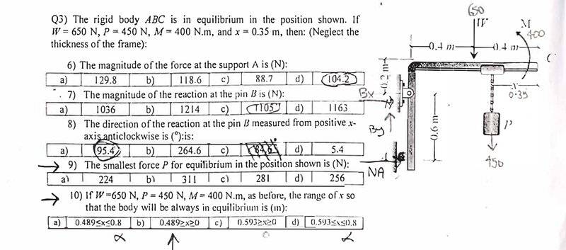

The rigid body ABC is in equilibrium in the position shown. If ##W=650N, P=450N, M=400N.m, and x=0.35m##, then: (Neglect the the thickness of the frame):
The samllest force P for equilibrium in the position shown is (N):

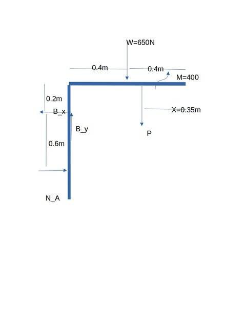

The first thing I did is to get the value of ##N_A## by the equaiton of ##\sum{}^{} M_B=0 \rightarrow 650*0.4+450*0.45+400=N_A*0.6 \rightarrow N_A = 104.2N## This is the first.
The magnitude of the reaction at B: ##\sum{}^{} F_y=0 \rightarrow B_y=450+650,\sum{}^{} F_x=0 \rightarrow B_x=N_A=104.2N##
This was until I came to the question whose required is to get the minimum value of P to keep the body in equilibrium, my question is: will I use the value of N_A nevertheless that I just got from the previous P value?? isn't this weird? so, what should I do?
Below is the FBD of the frame in the problem.

The picture for the problem its self
And I did refrence the forces by the arrows and the name of the points like##N_A##
At the minimum ##P## the contraption will almost start to rotate anti-clockwise around B. So what ##N_A## is associated with that minimum ?
Zero, isn't it?
Maybe I'm asking because the model answer for this problem used the ##N_A## we got earlier in the calculations, so that made me feel that there's sth wrong.
YehiaMedhat said:
Zero, isn't it?
The part of the diagram where ##N_A## makes contact has been drawn on, so it is hard to see the details. But yes, I would have interpreted it as just a buffer, so as P is reduced it should go to zero.
Ok, that makes sense now, so it'll be##\sum{}^{} M_B=0 \rightarrow 0.45P=400-650*0.4 \rightarrow P=311N##
Yes.
