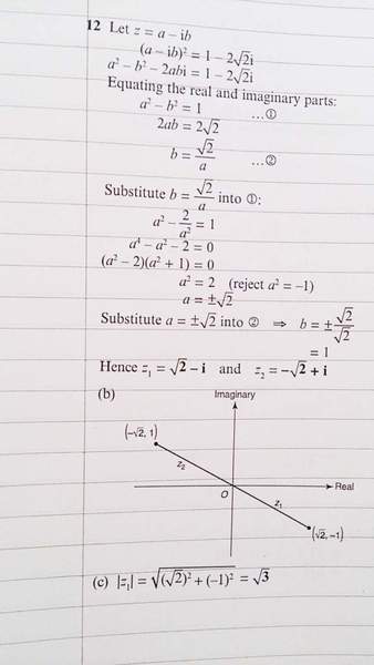

do u mean i should let z = a+bi , then i sub z = a+bi into z^2 ? by doing so, you assume that z1 and z2 , one of it must be conjugate to the others. am i right? here's the sample ans, why the author let z = a-bi , and not z = a+bi ?

No, z1 and z2 are not conjugate pairs, but one is the negative of the other. You can write the complex z as ##z=\pm \sqrt{1-2\sqrt2 i}##
As the imaginary part of z2 is negative, it is convenient to consider the imaginary part of z also negative. It does not matter. So z = a-ib, you square it, and compare with 1-2√2 i, so as the real parts are equal and the imaginary parts are also equal. Solve the system of equation for a, b.
Note that both a and b are real.
You can use polar form, too, but it is tedious. You convert 1-2√2 i to polar form numerically, determine the second roots, and convert back. You round at each step, losing accuracy.
I suspect you did not use the correct formula for the n-th root of a complex number. Check it.
