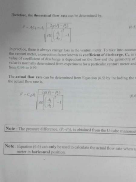

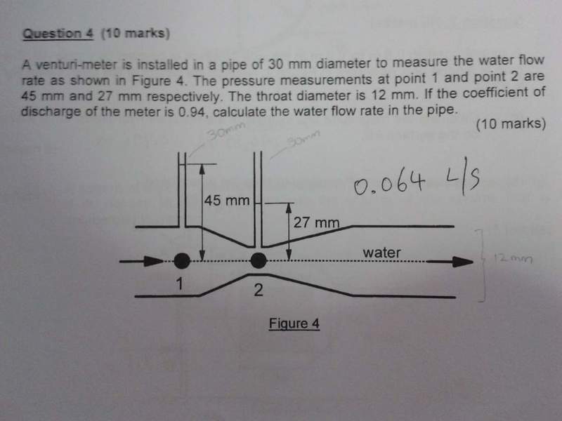

First I am trying to find the theoretical flow rate but I am not able to get the answer because since diameter of the pipe is 0.03m throughout, when I sub into the formula:
My A1/A2 will be 1, and 1-1 = 0. And I will get maths error whatever is divided by 0.
Am I going in the wrong direction?
Please advice, thanks.

No, the diameter is not 0.03 m throughout. Read the problem statement again.
I mean the 2 pipes at point 1 & 2 connecting to the venturi meter
As per the given question, at point 1 it is 0.03 m and at point 2 (throat), its 0.012 m.
I am confused. Is A1= Area of Left hand side pipe, A2= Area of Right hand side pipe in the theoretical flow rate formula?
"A venturi-meter is installed in a pipe of 30mm diameter" the pipe the question is talking about is it the 2 vertical pipes or the horizontal pipe?
No. Your book defines A1 and A2, maybe on the previous page, no?
The 30 mm diameter pipe is the horizontal pipe (isn't that obvious? :biggrin: ).
The vertical pipes are used for calculating pressures at point 1 and 2.
Ok I think I got it for the pipes. I am having problem finding P1-P2
Can I ask Since P1=P2
P1=pg(0.045)
P2=pg(0.027)
P1=P2
1000x9.81(0.045)=1000x9.81(0.027)
441.45=264.87 -> Stuck...
There is a note in my book saying "The pressure difference, (P1-P2) is obtained from a U-tube manometer."
Since this is not a u-tube manometer, how do I go about finding P1-P2?Thanks.

How P1=P2? :confused:
What is the pressure at a depth in a liquid?
I take the reference point at P1 and P2. Like how I did for Px and Py in the attached screenshot.What is the pressure at a depth in a liquid? I don't know sorry.

Looks good to me. Can't you find P1 and P2 in the problem you have posted?
P1=P_(atm)+(density)*g*(h1).
Similarly find P2.

Sorry, I should have defined it. P_(atm) is the atmospheric pressure. I can't help you further until you learn how to calculate pressure at a depth. Pressure at depth, which is taught in hydro statics should be in your notes or you haven't yet started with it? But its unlikely that you begin with hydrodynamics before studying hydro statics.
For this problem, P1-P2=(density)*g*(difference in heights of liquid in vertical tube).

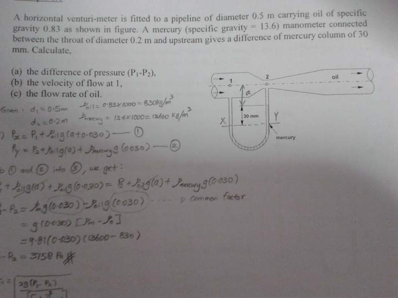

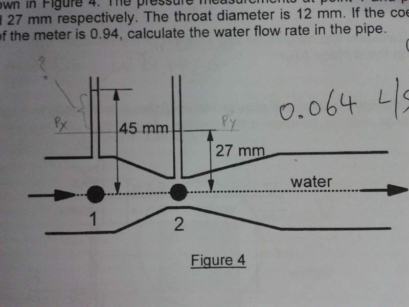

Ok. I have labeled my new Px and Py. But I think it's abit wrong because what do I do for the "?" part of water in Px.
But if it is wrong I thought my reference point should have the same liquid:confused:

freshbox said:
Ok. I have labeled my new Px and Py. But I think it's abit wrong because what do I for the "?" part of water in Px.
It would much easier if you place Px at the top most point on the liquid inside the vertical tube on the left.
Ok. How about my Py? I thought they should be on the same level with each other and with the same liquid too?
Because my post #9 referencing points are at the same level and having the same liquid.Please explain, I'm abit confused. thank you sir.
freshbox said:
Ok. How about my Py? I thought they should be on the same level with each other and with the same liquid too?Thanks.
Yes, take them on the same level.
EDIT: And don't call me sir, I am a student myself. :D
Ok same referencing point but Py is not having the same liquid as Px.
My lecturer said that referencing point must be at the same level and is having the same liquid.
I'm confused over this part.It's ok, it's a form of respect, if you don't like I won't call you that haha.. Thanks anyway for your help :)

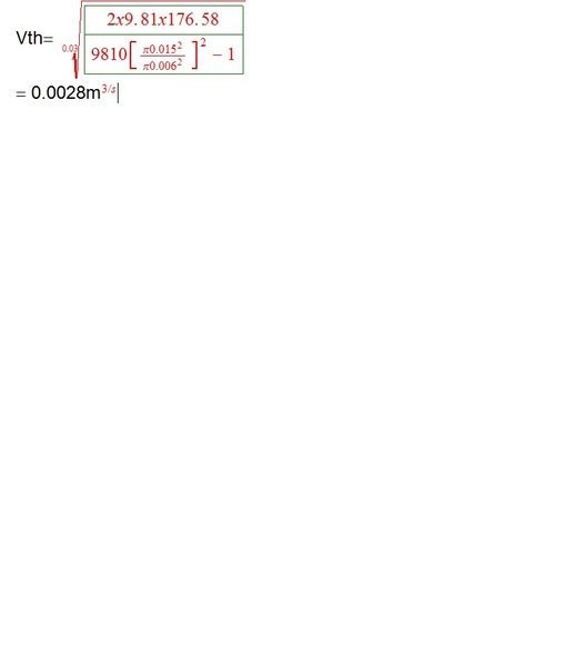

Answer wrong :cry:

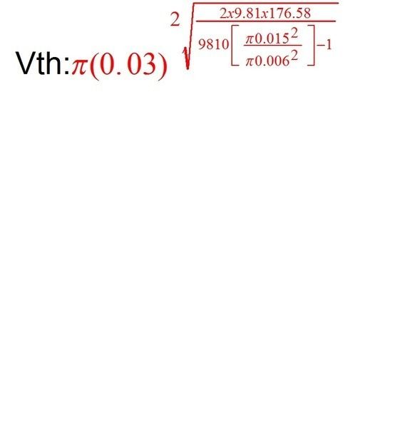

freshbox said:
Answer wrong :cry:
I can't read what's written in front of the root symbol. Also, you need not plug in the value of g, look at the formula, g cancels out so omit it.
0.03 is written in front of the root symbol. With or without the g I will still can the same answer right?
Why 0.03? The formula shows that its area in front of root symbol so it should ##\pi(0.015)^2##.
Yes.
Yea sorry missed out on that one..hehe.. I calculated as 0.27L/s. Did you get the answer?
