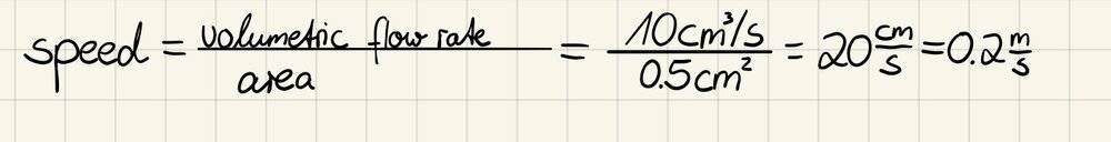

It is not an assignment but a problem I came across while studying for a quiz
See below, I inserted it, not sure if it applies to this problem though
So, I actually do not know, if the formula given applies to this problem or not, so I wanted to check
That formula looks like it is relating the flow rate to the pressure loss; you don't need that for the given problem. Can you write an equation relating flow rate, velocity, and area? That's all you need to do here.
I think that's what you are doing in the last two lines but you should write out the equation.
So, average speed equals volumetric flow rate times area? Just a bit confused, coz it was stated, that I have to find the flow rate
The answer choices are in m/s.
No, if you write this out showing the units (m^3/sec and m^2) you will see it cannot be, but maybe you can figure out the right equation.
Velocity is directly proportional to the volume per unit of time that flows inside the pipe.
The bigger the cross area of the pipe, the slower the flow.
Be careful with the conversion of units.
So, I guess that is the equation I was looking for?
Likes Lnewqban
