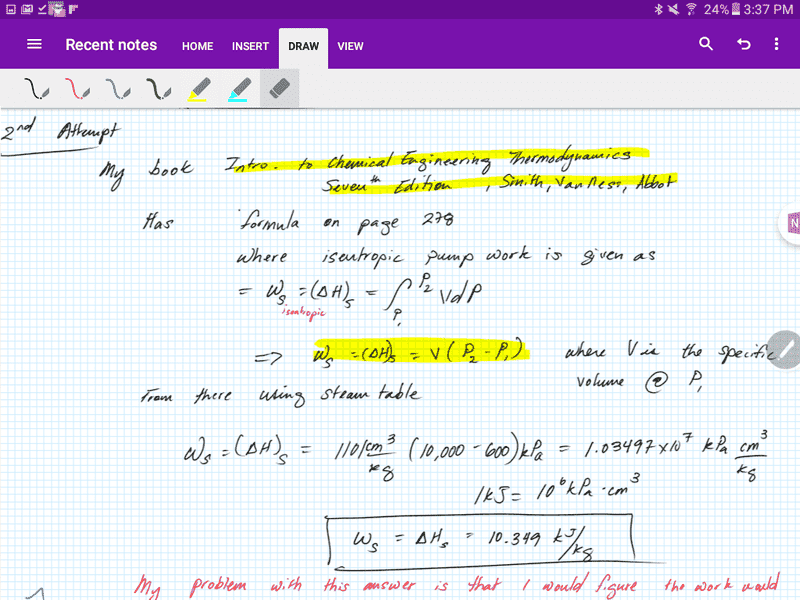

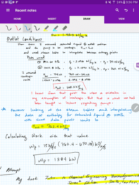

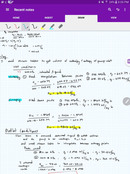

My attempt at the solution was to calculate the entropy of the fluid at the inlet. I know since a pump is isentropic
ΔS=0
And that through an energy balance for a pump
Wp=m (Hout-Hin)
Where the work i know has to be positive.
I interpolated from the data a value for my entropy (1.93) and since I know it to be isentropic I used that point to find a value for enthalpy. My problem is doing that route I get a smaller value of enthalpy going out because the entropy data points for my interpolation are larger than my calculated value. This result leaves me with a negative value for work which I know to be wrong.I did however attempt it another way with the approach of knowing it to be a saturated liquid at the outlet @10MPa which gave me a different value of enthalpy leaving me with a positive value for work.
Do I just use that value or do I need to interpolate other data points to get a value for entropy ie; using temperature Any and all help is appreciated

Here are my calculations. The first attempt was with the assumption of the pump being isentropic. I knew that through inspection my answer had to be incorrect just from my calculated entropy value not falling between the data points.
My second attempt was following an example in my textbook for work from a pump which is isentropic.
Thank you for your time,
D

I had trouble reading your handwriting, but I agree with both approaches you tried. I think the VdP approach gave the right answer. There was a problem with the steam tables approach, however. The stream at 10 MPa was a compressed liquid (at a greater applied pressure than the saturation vapor pressure). So you should have been using the compressed water portion of the steam tables to get the enthalpy of the outlet stream at the same entropy. Do you have access to these? I tried this and got the same answer as with the VdP method.
Yes I do have access to them. I just redid the work with those values and got the same answer as the VdP method as well. Thank you for leading me to the compressed water steam table! So the temperature had been lower than the saturation temperature meaning it was subcooled?
