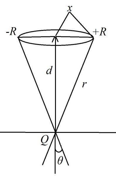

According to my textbook, the electric flux through a disk of radius R situated at a height d from the xy plane is given by:
##2 \pi k_0 Q [1- \frac{d}{\sqrt{R^2+d^2}}]##
Where ##k_0 = \frac{1}{4\pi \epsilon_0}##
I'm having some difficulty obtaining this answer.
Coulomb's law.
Flux ##\Phi = E A##
Where A is the area of the disk, in this case ##A=\pi R^2##.
I've attached a diagram I made of the method I am using here:
So ##cos \theta = z/r##, ##r=\sqrt{d^2+x^2}## (x runs from 0 to R):
##E= \frac{1}{4 \pi \epsilon_0} \int^R_0 \frac{2Qd}{(d^2+x^2)^{3/2}} \implies \frac{1}{4 \pi \epsilon_0} \frac{2QR}{d \sqrt{d^2+R^2}}##
Now, the flux is the product:
##\Phi = \frac{1}{4 \pi \epsilon_0} \frac{2QR}{d \sqrt{d^2+R^2}} \pi R^2 = 2 \pi k_0 Q \left( \frac{R^3}{d\sqrt{d^2+R^2}} \right)##
So why does my answer not match the one in the book? What's wrong with my method, and how can I get the correct solution? :confused:
Any help is greatly appreciated.
Good thing you posted the picture -- otherwise we wouldn't have known this is about a charge Q at the origin :wink:...
With flux ##\Phi = E A## you of course mean the vector product ##
d\Phi(r, \phi, d) = \vec E(r, \phi, d) \cdot \vec {dA}(r,\phi) ##, I hope ?
You do want to make that a lot clearer, especially to yourself. Also in the picture (drawing x at R is an unfortunate choice !)
Since there is no ##\phi## component of ##\vec E## (but there is an r component of ##\vec E## ! Fortunately it cancels when integrating over ##\phi##) this simplifies to ##d\Phi(r,d) = \vec E_z \; 2\pi r dr## and now you can integrate from r = 0 to r = R.

In post #1 it was $$
$$which does have a dimension of flux.
And for big enough R it goes to ##Q\over 2\epsilon_0## which is half the total flux. As can be expected.

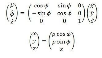

Here's my last question. I was told that it's better to use cylindrical coordinates for this problem to exploit the symmetry. Is it possible to derive this expression for flux, but using cylindrical polar coordinates instead?
Here's my attempt:
First I need to write the electric field in polar form:
##\hat{E} = \frac{1}{4 \pi \epsilon_0} \frac{Q}{r^2} \hat{r}## ...(1)
Since ##\hat{r}## is a unit vector, it can be written as ##r/||r||##. So (1) becomes:
##\hat{E} = \frac{1}{4 \pi \epsilon_0} \frac{Q}{r_x^2+r_y^2+r_z^2} \frac{r_x+r_y+r_z}{\sqrt{r_x^2+r_y^2+r_z^2}}##
Since this has length 1 I think we can just use unit vectors ##\hat{x}, \hat{y}, \hat{z}## on the numerator so:
##\hat{E} = \frac{Q}{4 \pi \epsilon_0} \frac{\hat{x}+ \hat{y}+ \hat{z}}{(r_x^2+r_y^2+r_z^2)^{3/2}}##
Using the transformation matrices I've attached, we find the following to substitute in:
##x= \rho cos \phi, \ y = \rho sin \phi, z=z## and
##\hat{\rho}= cos \phi \hat{x} + sin \phi \hat{y}##
##\hat{\phi}= -sin \phi \hat{x} + cos \phi \hat{y}##
##\hat{z} = \hat{z}##

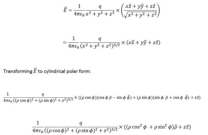

Oops, I made a mistake in my post above. I just converted the ##\hat{x}, \hat{y}, \hat{z}## so:
It still seems a bit messy to integrate... Is it correct now? So, basically I need to integrated this as mentioned in my last post?
You're making this complicated ! Post #2 already was expressed in cylindrical coordinates :rolleyes: .
Messy is relative. Once you remember that ##\sin^2+\cos^2=1## it simplifies. And think what you want to do with the ##\rho## component: for every point on the disc it is pointing in another direction !

Oh, thank you so much! It didn't occur to me to use that identity! :oops:
In fact, the 'dxdydz' bit was a typo. So it should become:
##\vec{E} = \frac{Q}{4 \pi \epsilon_0} \frac{\rho \hat{\rho} + z \hat{z}}{\rho^2 +z^2}##
##\Phi = \int d \Phi = \frac{Q}{4 \pi \epsilon_0} \int_0^{2\pi} \int_0^R \frac{\rho \hat{\rho} + z \hat{z}}{\rho^2 +z^2} d\rho d\phi##
Is this alright, or do I need to use the form ##\frac{sin \phi \hat{\rho}+ cos \phi \hat{z}}{\rho^2 +z^2}##?
Now you write it as if ##d\Phi = \vec {dE}## -- you equate a scalar to a vector !? And what are you integrating over ?
And there was a 3/2 power in the denominator that got lost ...
