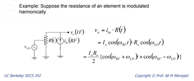

Thought experiment
What if i could modulate a resistor's value at one frequency , f1
and force current of another frequency f2 through it ?
By ohm's law the voltage across the resistor would be their product f1f2, wouldn't it ?
end thought experiment...
" Transistor " is a compound word , a combination of 'transfer' and 'resistor'.
I think of the transistor as a resistor (collector to emitter) whose value is modulated by base current.
So does this Berkeley professor , (properly giving credit, it's at)
http://rfic.eecs.berkeley.edu/~niknejad/ee242/pdf/ee242_mixer_fund.pdf
Circuit schematic of a variable resistor R(t) driven by LO source v_LO, with current source i_in (RF) and output v_o (IF); equations v_o = i_in · R(t) = I_o cos(ω_RF t) · R_o cos(ω_LO t) = (I_o R_o / 2){cos(ω_RF + ω_LO) + cos(ω_RF − ω_LO)}.
and that's what your single 2N3904 mixer is doing
(though emitter and collector are swapped from that professor's explanation)
Oversimplifying a little just to get started:::
2N3904's collector current is local oscillator frequency
and RF comes in on the emitter
base is effectively 'grounded' for signal by C14
so emitter-base current is RF input
and collector current gets multiplied by collector resistance which varies with base current at RF input frequency
and collector voltage is the product of the two frequencies
C17B sets Local Oscillator frequency
D3 trims local oscillator frequency to keep it centered on the station being received.

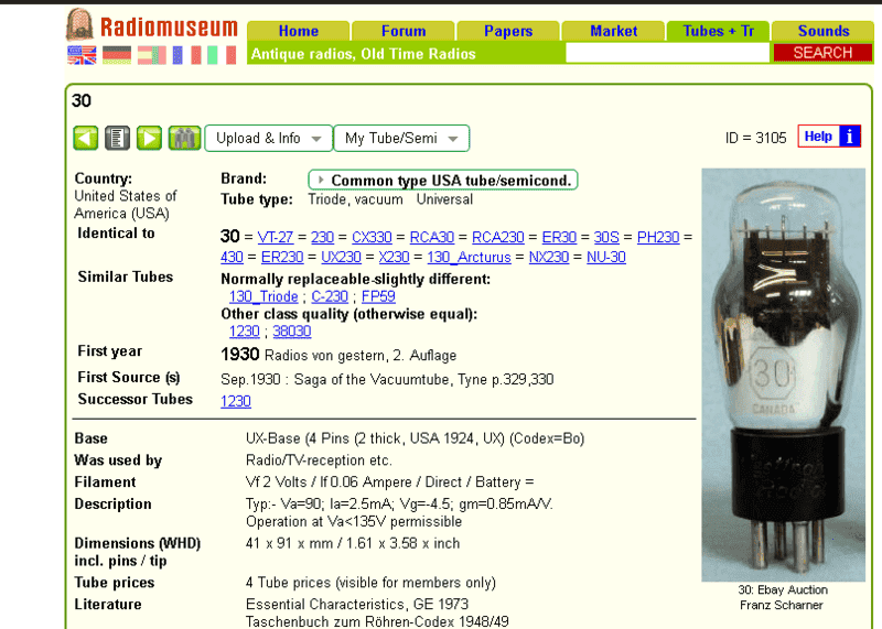

It really does work. Designers in early 20th century did it with four prong vacuum tubes.
https://www.radiomuseum.org/tubes/tube_30.html
Radiomuseum tube database page for the 30 triode vacuum tube, showing its identical and similar tubes, base, filament and dimensions, with a photo of the tube.
it really is that simple, in concept.

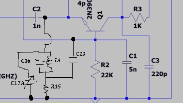

Hi Jim, thanks for so much info,
so you say local oscillator is at collector(but it most be also inductor not only c17B to set frequency)
and rf at base and emitter
and output is taken from collector? right...
but what C3 and L1, L4 and C16
LTspice schematic of a single-transistor mixer: Q1 2N3904 with V1 sine source 200m at 100MEGHZ, V2 12 V supply, R1 39K, R2 22K, R3 1K, R4 1K, C2 1n, C1 5n, C3 600p, C4 4p, L1 1000n, and a .tran 5U directive.
https://www.physicsforums.com/attachments/233040 I try to build one mixer in ltspice, but the formula and mixer i don't understand i need help
I build this one
  • LTspice schematic of a single-transistor mixer: Q1 2N3904 with V1 sine source 200m at 100MEGHZ, V2 12 V supply, R1 39K, R2 22K, R3 1K, R4 1K, C2 1n, C1 5n, C3 600p, C4 4p, L1 1000n, and a .tran 5U directive.
C3 provides feedback from output to input so that the amplifier will oscillate.
L1 just blocks AC signal from being short circuited to positive supply line
L4 and C16
(i'd appreciate a hand from one of our Ham Radio or @analogdesign guys here )
form a tank circuit in series with emitter
which i believe to be tuned via C17A to track RF amplifier , so as to siphon away RF signals not at desired frequency.
so its impedance is frequency dependent
I know nothing of spice
but your spice circuit shows no path for DC to leave 2N3904's emitter
while your real circuit shows one, L4 and R15.
There's clever AC coupling E-B via the tank circuit and C23
so this seemingly simple stage employs two feedbacks
hence will not lend itself easily to pencil and paper analysis.

I think C23 is just a decoupling capacitor, because C1 is such a large capacitance for 100MHz.
The input circuit of the SPICE circuit may not be correct. At LO frequency remember that the input circuit L4 C16 is just 10.7MHz above resonance, so is capacitive, maybe around 40 Ohms, and also C9 is only 5pF, which gives isolation from the generator.
In operation, circuits using 3-electrode devices as self-oscillating mixers are called autodyne mixers. The usual idea is that the tank circuit for the LO can be placed in the collector circuit in series with the IF transformer. Sometimes, feedback is obtained via a tickler coil in the emitter circuit. In this case it is via C4 between collector and base, with base grounded. I have found these oscillators very temperamental.
Some mixer circuits use a tap on the input coil where the LO voltage is zero, by bridge action, so that LO radiation is minimised. It is just possible that is happening here.
Currents at LO and signal frequencies flow in the transistor. One explanation is that the large LO current swing modulates the gain of the transistor and this causes the signals to be multiplied. Another explanation relies on the non-linearities of the transistor.
My personal view is that the circuit is a complete mess!

Hi, i build this one like Notch filter is good? of i make mistake ? THIS OVER L4 AND C16, THEY FORM NOTCH FILTER , what frequency have to be?
LTspice schematic of a parallel LC notch filter: AC voltage source V1 with Rser=50 driving a parallel tank of C1 31p and L1 79n, feeding load R1 50; directives .ac oct 10MEG 10MEG 200MEG and SINE(0 1 10MEG).
LTspice plot of a notch filter response, V(out) in dB against frequency from 10MHz to 190MHz, with a sharp dip to about -82dB near 97.7MHz.
  • LTspice schematic of a parallel LC notch filter: AC voltage source V1 with Rser=50 driving a parallel tank of C1 31p and L1 79n, feeding load R1 50; directives .ac oct 10MEG 10MEG 200MEG and SINE(0 1 10MEG).
  • LTspice plot of a notch filter response, V(out) in dB against frequency from 10MHz to 190MHz, with a sharp dip to about -82dB near 97.7MHz.
