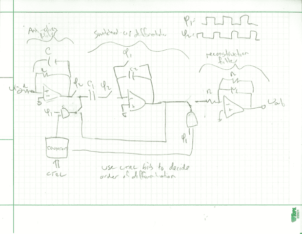

Anyway, here is how you would build a circuit to do an arbitrary number of derivatives.
Here's how it works. On the left is a continuous-time anti-alias filter to make sure there isn't any aliasing when you sample.
In the middle is the switched-capacitor differentiator circuit. It is driven by a two-phase non-overlapping clock. On Phi 2 it either samples the input or the fed-back signal (the drawing should have a AND gate driving the first Phi 2 switch. The output of the anti-aliasing filter should only be sampled on the first loop... sorry!) Then the first difference of the input is taken by the sampling of the signal onto C1 and then transferring it to C2. (when you map the real number line into the unit circle by sampling, the first derivative collapses into the first difference). The counter counts each clock period the recirculates the signal until you are done. You can take the second difference, third difference, whatever. The increased noise is rejected by the reconstruction filter on the right which converts the signal back to continuous-time.
You have to follow Nyquist here and make sure the highest frequency in the input signal is significantly less that twice the sampling rate.
I'm almost positive you have no idea what I'm talking about. I'm begging you to learn basics. If you must jump years ahead, here is a good writeup on switched-capacitor techniques:
http://www.aicdesign.org/scnotes/2001notes/Chapter09(6=4=01)-2UP.pdf

The circuit I posted *is* the analog circuit whose algorithm I described in the quote you posted. It is not DSP.
Now, to clarify this, here is the OP's original quote:
I'm now thinking about applying a circuit to a signal multiple times. For example, I want to differentiate a signal f(t) using a differentiating amplifier. But I'm interested in finding nth derivative of the signal, and I don't want to hard wire a series of amp's. I just want to use the same amp.
The OP wants an analog circuit that reuses a single differentiating amplifier. That is exactly what I posted. Where in that quote did the OP specify that the differentiating amplifier had to be implemented using an RC-opamp structure?
To reiterate, the circuit I posted implements the algorithm you quoted. The counter is the loop counter. The first switch (I omitted the AND gate on the switch driver) implements the sampling function. You can read the explanation I already put for how the switched-capacitor amplifier works.
This kind of thing *can* probably be done using opamp-RC differentiators but it would be really tricky (continuous-time delta-sigma modulators use a similar type of circuit). In that case I would imagine there would be severe noise problems. But maybe not (depending on filtering).
So, are you misunderstanding the circuit I posted, are you misunderstanding the definition of DSP, or something else?
The OP asked for an analog circuit that provides n derivatives using the same amplifier. That is what I posted.
Ok I've only just found time to have a good look at this circuit and I can tell you that is extremely flawed on many levels. Obviously I know it's only a "overview sketch" so I'm not expecting all the fine details to be covered, but even so it looks pretty flawed to me.
- Firstly the differentiator is inverting, making the feedback inconsistent for taking differences with the previous input voltage. Ok that's no biggie, easily fixed with an inverting amplifier.
- Secondly there's no charging path for C1 under the feedback conditions. That is, C1 is disconnected (at one end or the other by either phi1 or phi2) at all times after the first input voltage sample (n=1). The output voltage of the differentiator will always be zero after n=1. You can't fix this by overlapping phi1 and phi2, because then you'll have a positive feedback loop on the opamp (assuming you fixed the previous flaw) and it would slew to rail. You could probably fix this with a sample hold after the phi1 switch (to c1 input) in the feedback loop.
- Thirdly however I just don't think this finite difference approach can even work properly on these recycled samples rather than consecutive samples of the input. I'm assuming you're thinking in terms of a finite difference approx to the derivative like [itex]1-z^{-1}[/itex] for the first derivative and [itex]1 - 2 z^{-1} + z^{-2}[/itex]
For example, even if I assume that your circuit is "fixed" so that it correctly compares the voltage of the previous input/feedback (stored on c1) with that of the most recent output stored on the sample/hold (forgive me if this is not how you envisage it, this is just my best guess at what I think you are trying to achieve), then when I analyze the output for a 2nd derivative then I don't get what I would expect.
Take a series of input samples 1 2 3 4 ..., with an initial capacitor voltage of zero. I get the following sequence of output sample for n=2. Output = 0, -1, -1, -2, -2, -3 ..., doesn't look right. The finite difference [itex]1 - 2 z^{-1} + z^{-2}[/itex] would yield a sequence of zeros. This confirms my initial suspicion for this type of implementation.
You're quite right, both about the small errors and the fact that it doesn't seem to take the second difference correctly. Obviously this was a sketch I made to try to prove a point (not sure I proved it haha!). To do a real second difference I think you need a more complex structure (as in a high-order delta sigma modulator (without the modulation).
My gut tells me it is possible, but I'm not going to look into it.
The bottom line is doing it this way is crazy. You should use a computer. I was responding to the comments that it was "impossible" to do it in an analog way, and I dispute that.
Thanks for taking the time to go over the circuit!
