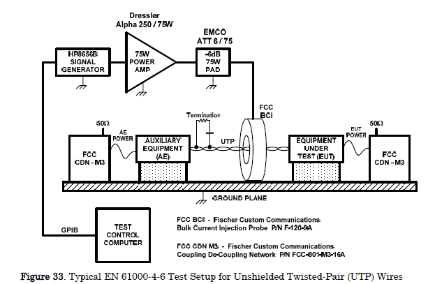

Which of the 2 versions? If the non-resonant one, you will likely need a -6dB matching pad between your amp and the EO device, so that increases the output voltage required from your amp...
It is the non-resonant one. What is a matching pad (I am just getting started with working with RF for this project)?
BillKet said:
What is a matching pad?
When a 50 Ohm output matched amplifier drives a non-50 Ohm load, it's important to use a matching network ("pad") between the amp and the load, to avoid damaging the amplifier. For example, in some RF immunity testing that I have set up in my work lab right now, I use a 75W power amp to drive a coupling coil with signals from 150kHz to 80MHz to test the immunity of IoT devices that we design and build. The input impedance of the coil varies with frequency, so a -6dB matching pad is placed between the amp and the coil. That reduces the drive available to the coil, but is necessary (and a part of the standard test setup definition) in order not to damage the amp.
