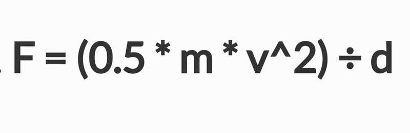

I am trying to find out the amount of force that a free-falling body will have, as it hits the ground from a distance of 2000 km from Earth's surface.(Considering air resistance)
What I know about the body:
Area of the body=20199.04 mtr²
Density of body=985 Kg/m³
Thickness of body= 75 mtr.
After scaling the area 10 times,(since the actual body is 10 times larger)
Area of the scaled body=2019904 mtr²
Volume of body: area*thickness
Therefore, volume=2019904*75=151492800 mtr³
Mass= volume*density
Mass= 151492800*985
= 149220408000 kg
Terminal velocity of body:
Density of air=1.225 kg/m³
Drag coefficient of the body, C =1.98
Using the formula for terminal velocity,
Vt=773 mtr/sec (~ 2.25 Mach)
Force of impact,
'V' is taken as the value of terminal velocity (Vt)
Using the above formula, I have found the force,
F= 1,463,766,251,524.9 kgf
Or = 14,354,643,310,487 N
Can anyone help me validate this value??
Have I used the proper procedure to achieve the force value?

First of all, you are using way too many significant digits. Your final result contains 14(!) significant digits, which would indicate that you know all input values with a relative accuracy of the size of a proton compared to a meter.
Second, it is not clear what you consider ”amount of force” to be, or that you understand what should go into your formula. Can you describe in words what all parts of the formula describe? If not, then you are likely just stabbing in the dark, which is never a good approach to have. It is better to understand what goes into the expressions and what they are saying.

It is still not clear what you mean by "much of force does the free body carry". What force on what object are you trying to compute? A force is a transfer of momentum per time from one system to another.
Tankoyu said:
And all those formulae are taken from internet so I'm not sure if they are applied in the right context[emoji28]
I strongly suggest against just taking formulae without understanding the appropriate context. It will tell you nothing. In order to get something out of the exercise you need to understand what you are doing.

You can calculate an average force that they apply on the ground if you know the kinetic energy and "stopping distance". However this method isn't really applicable to something impacting the ground from space because it has more in common with an explosion than an impact.

Force of impact,
This formula is 'not incorrect' (note the double negative) but you need to think what it actually refers to. The d in the equation refers to the distance, under a constant force, over which the work done is equal to the Kinetic Energy of the object on impact and the object is brought to rest. So, unless you know the distance traveled by the object as it is brought to a halt in the concrete / soft mud / water / crash mat and unless you can be sure the force is the same throughout the impact, the value F can't be known.
This is why you have already been told in this thread that the most meaningful quantities are Momentum or Kinetic Energy. They are properties of your falling object and don't depend on what it lands on. Momentum and KE are alternative ways of looking at 'that thing' a moving object posses.

Forces can be applied for a short or long time so force isn't really a good measure of the amount of the damage caused.
I think in your case energy is a much better measure of the likely damage caused, for example you can compare the energy of the object with an explosive like TNT. Using your calculated values...
Mass = 150,000,000,000 kg
Velocity = 773 mtr/sec
The kinetic energy would be...
0.5 * 150*109 * 7732 = 45 * 1015 Joules
The energy in 1kg of TNT is about 4*106 Joules
So your impact would be a bit like setting off...
45*1015/4*106 = 11*109Kg of TNT
According to Wikipedia this is about 100 times the energy released during the extinction event that killed the dinosaurs 66 million years ago...
https://en.wikipedia.org/wiki/TNT_equivalent
I think that gives a reasonable impression of the damaged caused.
