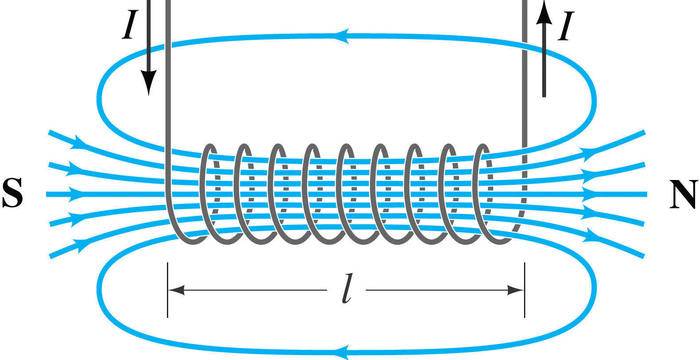

We (my group and I) wrapped a 40 cm PVC pipe in copper wire (very densely and for almost the entire length), applied a current to it, and dropped a permanent magnet through the tube. The current was applied such that the magnetic field of the solenoid (as we modeled it) would point upwards, opposite gravity.
By connecting two extra coils of wire at each end to a special data capture instrument, we could record the induced current in these coils as a function of time (giving us an accurate way of measuring the descent time of the magnet).
When we applied increasing levels of current, the data (and observation) showed very clearly that the magnet was slowing - at one point it even stopped at the top of the tube (until we pushed it).
That's the context - the problem is, then, what is the force opposing the magnets motion? (Not numerically but conceptually)
I originally thought that the eddy currents induced in the solenoid (by the passing magnet) would affect the drop time (thus explaining the force opposing the magnets motion). However, when no current was applied, the drop time of the magnet was very similar to what we would expect from classical kinematics (little change), and I don't believe eddy currents explain why a greater applied current affects drop time.
Any assistance is much appreciated.

You are asking how or why does the magnetic field of a solenoid interact with the field of a permanent magnet?
Diagram of a current-carrying solenoid with length l, showing blue magnetic field lines running through the coil interior from S to N, looping around outside, with current I entering at the top and leaving at the bottom.
https://www.miniphysics.com/ss-magnetic-field-due-to-current-in-a-solenoid.html
Yes, I am wondering why and how the permanent magnet passing through the magnetic field of the solenoid is experiencing a repulsion (thus slowing it's descent time).
How about drawing a bar magnet in the middle of the solenoid and sketching in some field lines like Nascent0 did?
Would you have the same question about two permanent magnets repelling each other?

I did not think of it that way - so it is being decelerated as a result of like poles repelling each other - which would explain why the deceleration increased with current, since the magnetic field inside the solenoid increased?

Of course, no sooner had i pressed send than I realized that the repulsion I'd thought about does not apply "in the middle of the solenoid", only at the ends!
But you would have noticed the repulsion from the bar entering the solenoid and detected it reaching the end before it was greatly accelerated out of the solenoid.
The permanent magnet in the solid copper pipe experiences drag all the way down, because it is continuously generating current just in front and just behind it all the way through - being repelled in front and attracted behind.

I am coming to it simply in a qualitative way, based on the notion that a bar magnet is like a solenoid (externally.) So the force between a solenoid and an external bar magnet is like the force between two bar magnets (which I think you may find explanations of.) Inside a solenoid there is a uniform field, so I'd expect there to be no net force on the bar magnet when it is parallel to the field. When it is not parallel, there would be a torque trying to make it become oriented with its field in the same direction and sense as the solenoid field. When it is parallel to the solenoid field, but its field is in the opposite sense, then it could be in unstable equilibrium and would turn around at the first opportunity. (Maybe some of the slowing you observe is due to the magnet being pushed out of line and rubbing against the plastic tube?)
All of this can be seen qualitatively by using Faraday's idea of field lines and I don't suppose anyone is expecting any quantitative calculations.from you.
Your observation
is consistent with the idea that the repulsion happens only at the end of the solenoid. Once you push it past this point, I presume it traveled through the remainder of the solenoid without stopping, then accelerated away from the other end..
