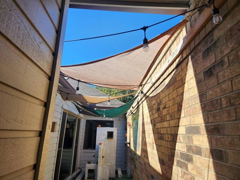

I have some triangular sun-sails (their function is to provide shade) attached at one point to the facia of my roof and on the opposite side of the triangle to a 2x4 that I have screwed into an existing brick wall. The triangle height of the sails are 8', and the distance from my roof facia to the wall is about 7', so the sails have some sag. There are three of them, they are alternating in orientation, so the first sail has one grommet on my facia and two on the brick wall, the second has two on my facia and one the wall and the third is like the first. They are not perfectly parallel to the ground, but I didn't put a deliberate tilt on them either, they are roughly flat, within the error bounds of an eye-ball only installation. The wind, of course, is not regular, so I don't know that it matters if I tilt the sails or not.

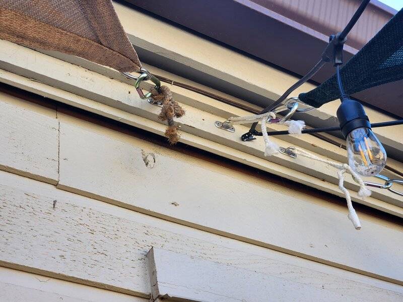

Sometimes there is significant wind blowing across these sails. The 2x4 attached to the brick wall has shown no issues. The facia on my house gets pulled away from the house frame over time. Its attached with framing nails and these get worked out of their holes after a few months of being pulled on by the sails.
So I wondered if I used elastic attachments instead of firm rope whether I should expect the load on the facia to be relatively lower or higher or not change.
What I am doing now, which I am not comfortable with but am living with it nonetheless, is to take a hammer and bang the facia back flush to the house every once in a while. I don't want to just screw the facia in, because I don't know if that will just transfer the problem to whatever I screw the facia into, back inside the frame of my house where things may pull apart and I won't even see it happening. I think I need to take the sails down unless I can figure out a way to not need to attach them to my house, but I haven't given up quite yet.

Triangular sun shades will always flap in the wind, make noise, tear out the grommets, and damage the support structure. That is simply because a triangle is flat. It takes a doubly curved surface, with four corners and a stretchy fabric to be stable and not flap. A doubly-curved surface is formed when the four mounting points are not co-planar.
They make triangular shade sails because they look right, are easy to attach, so they seem to sell well, but they all flap in the wind. There are some rectangular shade sails available that do not stretch, so they also flap. The manufacturers do not care enough to get it right.
Make a rectangular shade from a knitted shade cloth that will stretch, (from the garden centre). Stitch a hem for a cord or a wire along each edge. Attach two corner points to the fascia at the same height, the other two corners attach to two points at two different heights on the wall. When it is tensioned, it will form the doubly curved surface that will not flap. Tension in the edge cords will pull the edges into a curve that will prevent flutter.

Here are the shades and a shot of what the facia looks like after a while. I mis-remebered the brick attachement, I guess I put the 2x4 on after the sails and to string the lights to - the sails are attached directly to the brick. That wall is actually the exterior wall of my house, this little open-air area is notched out of the floorplan in my home. I put the sails up to give some plants a shot at survival in the Dallas summer. When the sun hits that brick wall, anything close to the wall gets too hot to survive.

Yes. The centre of a flat sheet can move with minimal restraint in the lightest winds. Double-curvature pre-loads the surface with tension from two directions, which raises the minimum wind speed (pressure) needed to significantly deflect the surface. The fabric life is greatly extended by double curvature because it eliminates fatigue due to flapping in the wind.
