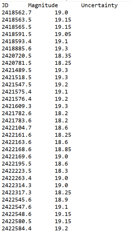

Summary:: If given a set of data points for the magnitude of a cepheid variable at a certain time, how can we use Fourier series to find the period of the cepheid variable from the equation of the light curve? Where can I find data points for M31_V1?
If given a set of data points for the magnitude of a cepheid variable at a certain time (JD), how can we use Fourier series to find the period of the cepheid variable?
I'm trying to do a math investigation (IB math investigation) on finding the period of the cepheid variable M31_V1 from data points for the magnitude of the cepheid variable at a certain time (JD). However, to find the equation of the light curve using Fourier series, the period must be given already right? How can I find the period then?
Also, I'm trying to plot the data points from the AAVSO (https://www.aavso.org/data-download/aavsodata_5f913c1d4f3f0.txt), but it seems like the points are not forming a curve. Can I find data points for the magnitude and JD of M31_V1 anywhere else?

no_drama_llama_77 said:
From my calculations
Period for the left frequency: 502.3156753… days
Period for the right frequency: 31.38948703… days
A. Please watch the precision. You are not getting 11 digits here no matter what you do: that's 10 ms over the entire observing period.
B. Please wtach your units: the tick marks go from 0.005 Hz to 0.030 Hz. That's a period from 30 to 200 seconds. You can't see a 30 day period on this plot, nor distinguish it from 500 days.
If you sample every 2.4 hours, you can't see a 200 second effect. It's got to be noise.

A. I wasn't sure what the data uncertainty was, so I rounded my figures to 3 significant figures in my written report. Will that be appropriate?
B. When I apply the Lomb Scargle Periodogram to the data, does that mean my frequency is actually represented by the units (1/days) rather than the usual (1/seconds), since the AAVSO data measures the period using Julian dates (days)? I may have mislabelled my spectral density graph.
I obtained 502 frequency by dividing 1/0.00199078. I obtained 0.00199078 by estimating the coordinates of the second-highest peak on the left

Do you think so? That means you think you know the period to one part in a thousand. (And for that matter, that the period is stable to one part in a thousand)
If days are the input than 1/days is the output.
That said, I am still far from convinced that you are doing anything besides chasing fluctuations.
A. If you split the data into pre-1940 and post-1940 do you get the same answer?
B. If you fit even and odd data points do you get the same answer?
