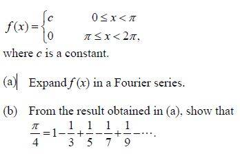

1. Homework Statement
Consider a periodic function f (x), with periodicity 2π,
Piecewise function f(x) equals c for 0 ≤ x < π and 0 for π ≤ x < 2π, where c is a constant. Below it, part (a) asks to expand f(x) in a Fourier series and part (b) asks to show that π/4 = 1 − 1/3 + 1/5 − 1/7 + 1/9 − ...
##A_{0} = \frac{2}{L}\int_{X_{o}}^{X_{o}+L}f(x)dx##
##A_{n} = \frac{2}{L}\int_{X_{o}}^{X_{o}+L}f(x)cos\frac{2\pi rx}{L}dx##
##B_{n} = \frac{2}{L}\int_{X_{o}}^{X_{o}+L}f(x)sin\frac{2\pi rx}{L}dx##
##A_{0} = C##
##A_{n} = 0##
##B_{n} = \frac{-C}{\pi r}cos\pi r##

This post should have been sent to Calculus and Beyond Forum.
Your picture is hardly readable. Better to type the text in, or write it clearly and make a better picture.
The formula for the b coefficients is not correct. What happens in case of even index? What is b2, for example?
